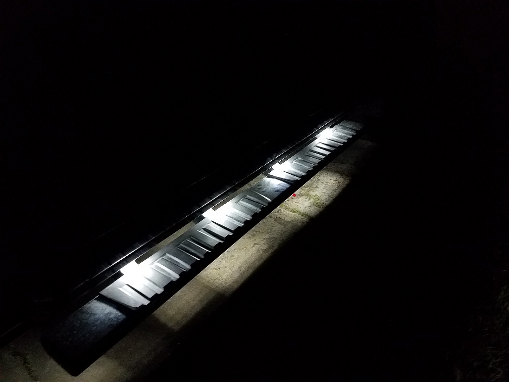

Running Board LED Lights
Are you running 1 continuous strip or 2 separate strips per side?
Looks like you could bend that angle to make the strips hit the step more and still keep them hidden.
I have 2 led strips per side. If you have one long strip it would still work. Just get a piece as long as you need it. Cut around where ever you would need and it wouldn't affect its integrity or anything. I could definitely bend it to achieve a better angle, but it's not a big deal to me. The wife can still see where she's stepping just fine

CAN SOMEONE POST A LEVELED PICTURE FROM THE SIDE WHERE YOU CANNOT SEE THE LED STRIP DURING THE DAY? CURIOUS TO KNOW WHERE YOU PUT IT SO YOU DONT HAVE TO FABRICATE ONE...THANKS IN ADVANCE...GONNA BE PUTTING MINE UP THIS WEEKEND SO WANTED TO GET IDEAS
You can't see my led strips from any angle unless you're laying under my truck8e74074e19ce16ccd10c48b868c53a0f.jpg9b1373983a1117ec78edce9405defbfd.jpg6877560a1c96f400052d2e6509fd8b32.jpg

Thanks...and just to confirm you don’t have the lights attached to the running boards? The lights are attached to the actual truck?
Yes they on the truck. Look for my previous posts in this thread and I show how I did it.
