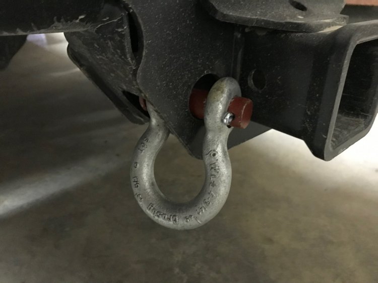

Or you could really do it right. I put on Crosby 1018133 shackles with 3/4" pin and rated for 4.75 tons each.
Yeah..... suppose that might be enough for this cable..... be close though [emoji849]96689b1bb80778278d0ab5ead77af08b.gif
