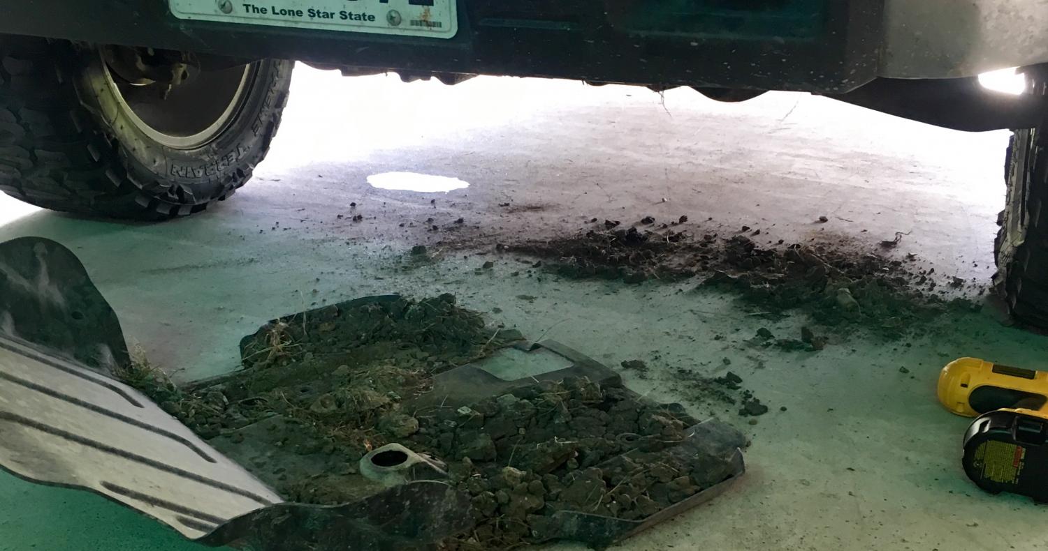

About a years worth of mud and grass etc. lots of cuts in the plastic. My truck lives off the pavement 90% of the time. Got a hell of a bend on the driver side crossmember under the t case.
About 25lbs after it was all scraped out of guard and the 2 support braces under the diff.

Did you remove the 2 thin braces under the front diff when you bolted up the new bottom skid?
Yes they have to be removed.
