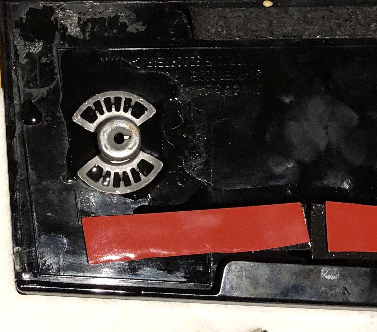

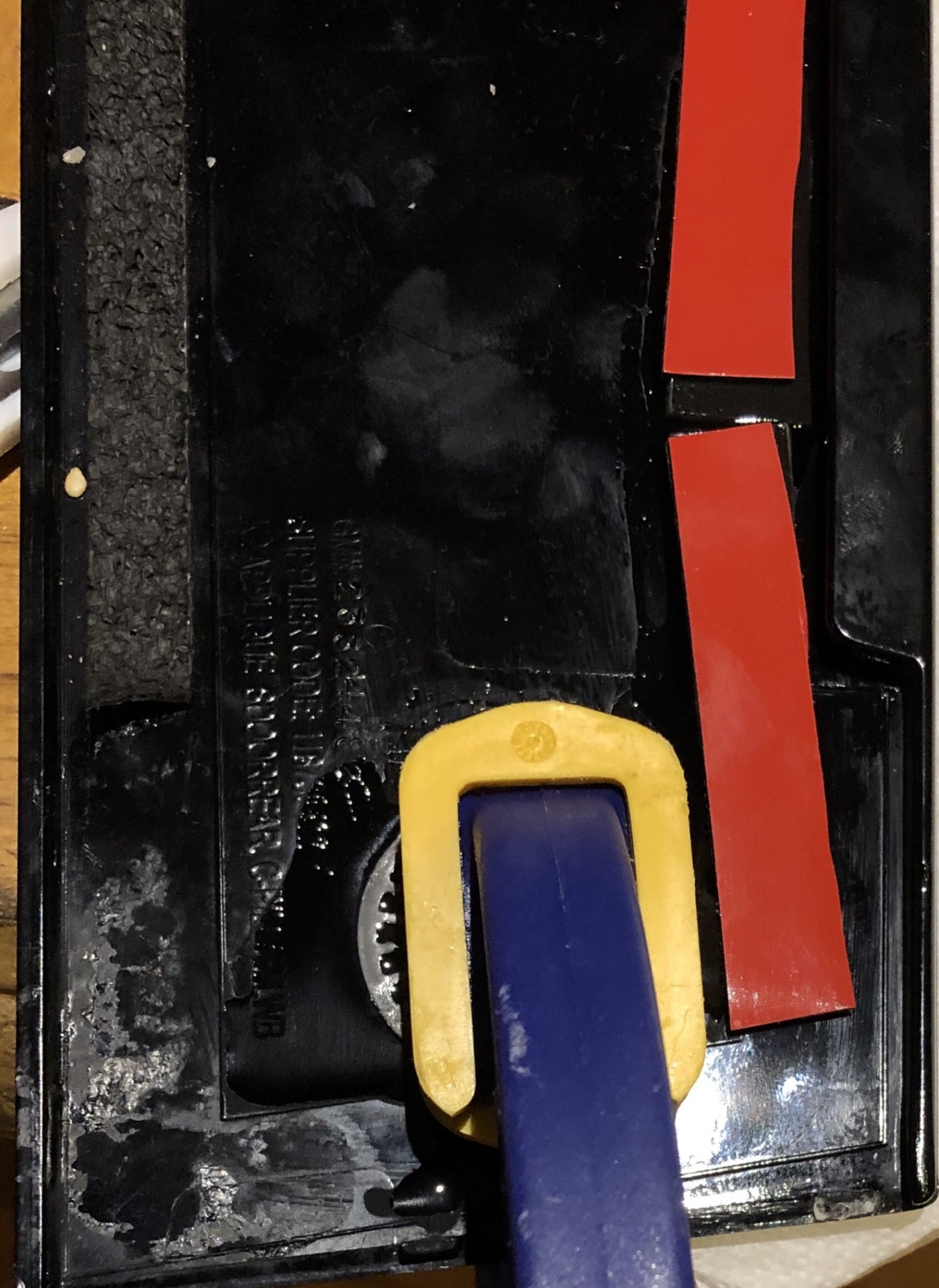

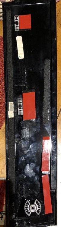

The problem with door applique is poor quality glue used on the radial clip and it separates from the plastic trim. There is no need to buy these ridiculously high priced items. I used a Marine epoxy (5200) and re glued the all the clips (clamped them over night) and used some 3m double sided tape in various places for added strength. I changed all of them (including the ones that were fine) total 8 on all doors. So far have driven for six months and no issues. They look solid. See pictures
