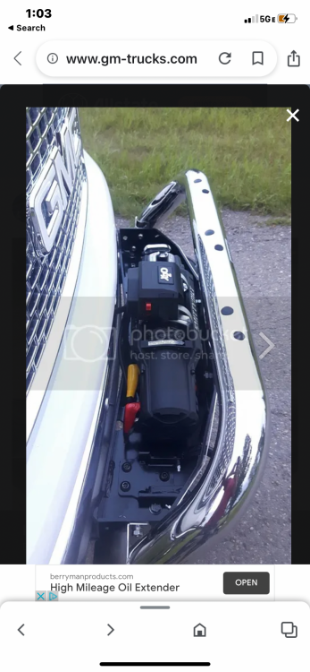

Hey guys. Lurked through every post for winches on this dang forum. Saw a nice Chevy job but my truck is a bit different. Going to pull the front bumper soon and see if I can fab a tray up and a skid plate but hardly any room.
Any of you gotten a winch on your 2015 GMC 1500. Either hidden or on an aftermarket bumper. Wish SCA would fix the design of their bumper to accept a bigger winch than that little warn they offer for 1700+. Not gong that route. Any input would also help!
I have a Westin winch mount/brush guard and a WARN Zeon 10S.

Doesn't that bother you being stuck out and really not protected at all? I go though lots of brush and ditches plus have run ins with hogs and deer sometimes. I just hate that company's now days don't build decent HD replacement bumpers for our trucks. All the hippie cowboy trucks on the road now days with light bars and fancy wheels.
I'm also interested in adding a winch, preferably a hidden mount. I contacted Rough Country to see if they were coming out with one for 2014 and up models, their response was, "not at this time." Right now I'm leaning toward the Westin unless some company comes out with a hidden mount or the one Rough Country has for 2007-2013 will fit with a little work.
Nah, the Westin winch cradle is tough, mounted to the frame in multiple points...the most that might happen is the control box get crunched from a deer impact. I wasn't impressed with the limited guard options, so I built one to withstand a decent impact...
Getting the front dinged slightly isn't as much of a concern as getting home afterwards is to me...
I think it will fit the frame no problem. I doubt it's been changed in years. But the problem lies in the new front bumpers on the gmc 1500. No hole to pass a wire rope or synthetic rope through. And attach a fair lead. I'm thinking I might be able to make my own plate then get an aluminum plate and break it at the angle I need to keep it stream lined off the frame horns and bumper mounting area. Then make that my skid plate and cover the winch underneath at the same time. This retaining tow hooks, factory look, strength, protection and a winch added to the arsenal! Iron cross quoted me 1300 for a full guard bumper winch ready that replaces factory chrome bumper and plastic filler but that in coated. I'd get it bedlined.

No seriously. It's a stout design you ran with. And I don't question the strength of the mounting. Weston is reputable. Honestly I think it just looks, half assed. Like they looked at it and said lets just add 2 feet on the front and be done with it.
With all the coolers and whatnot behind the bumper, and the fact that you really need at least a 10k winch for a 2500, not really much in the way of options, at least four years ago. I didn't want a full bumper replacement, so that limited me to cradles.
The one thing with the Westin mount I will note, if you add their tow loops (an option for their cradle); they may interfere with your winch of choice. I had to modify the passenger side one to clear the Warn VR12000 I chose...
