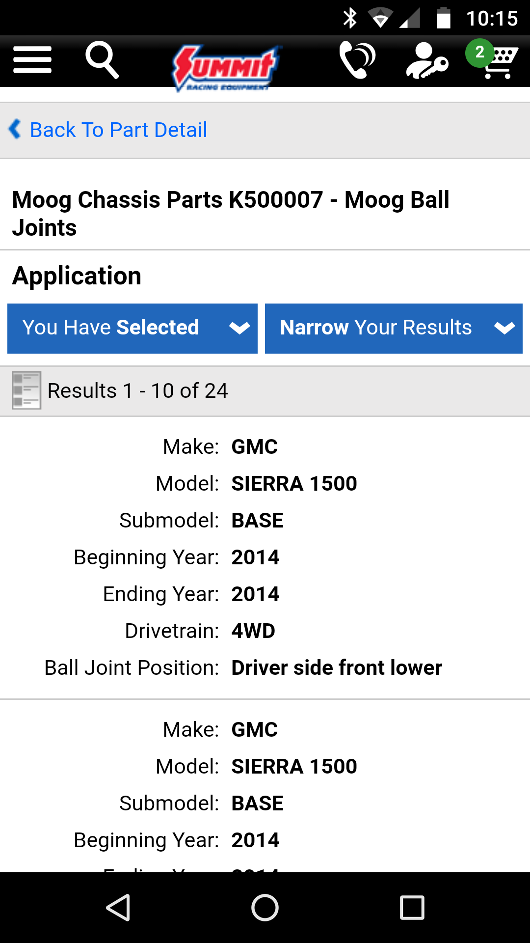

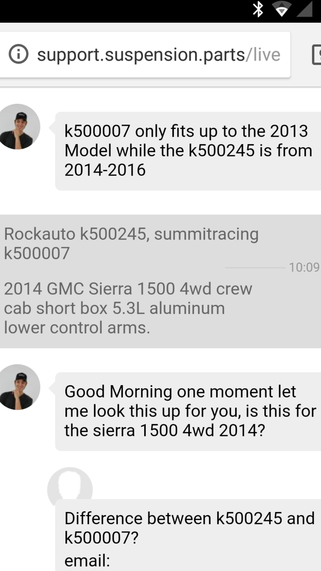

I'm at 26k miles and having the same problem. Deciding on whether to do control arms but ball joints are deff shot. 2.5 level on mine. Curious what the diff is between the ball joints you posted and these
https://www.summitracing.com/parts/mog-k500007/overview/year/2014/make/gmc/model/sierra-1500
Also I haven't been able to find just uppers- most come with control arm?

Did you ever get this done? If you have aluminum lowers, do you have part # of balljoint used?
Anyone who has actually replaced the lower ball joints in the aluminum lower control arms, could you give a quick summary of the parts, procedure, labor time, tools, and/or issues?

Info from MOOG...
