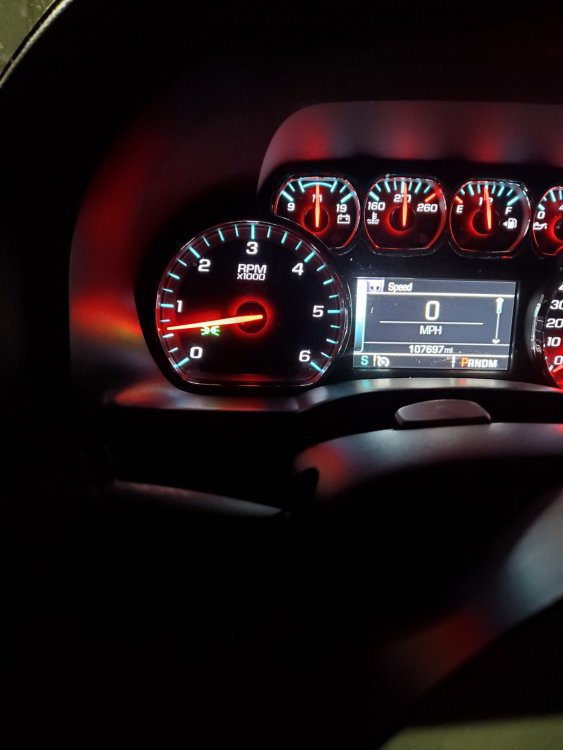

What if the fluctuation is at idle? Like in park? Anyone know what this is about? If i give it throttle in park it stays at that rpm until i turn my truck off. Please help..... this truck was too expensive for all this crap. Hahaha
Welcome to the site.
How about a little more info about your truck. Looks like you are over 100000 miles, so my guess would be your torque converter is having issues.
