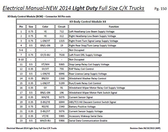

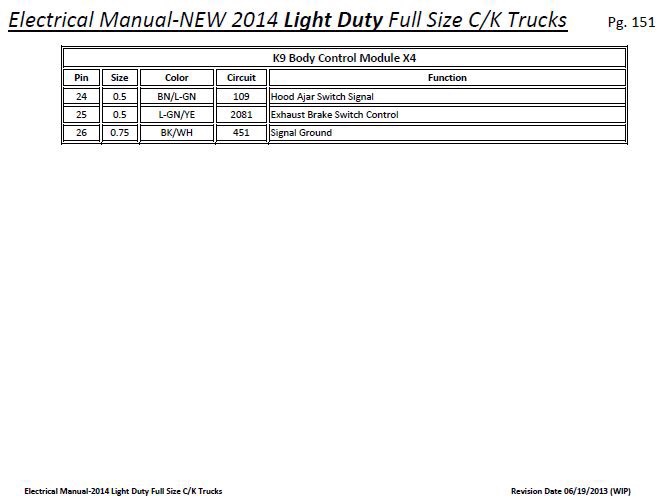

Has anyone built a logic circuit to turn on the fog lights whenever the lights are on (low or high beam)? I started looking at the upfitter diagrams and there is no relay control for the lights, but there is a control.. it is a logic high with the lights off and goes low when lights are on. I was thinking of installing a relay with b+ and the logic of this light circuit making up the coil. Then switching b+ on the NO side of the relay and the common to the fog lights relay control.
Anyone do this yet or know of an easier way to make this work? Ideally I would like a 2-4-6 (fog, low/fog, high/fog ) option like the old body style trucks.

I have mine going to the running lights/side marker lights. I can still use the button to run just fogs and when my headlights turn on my fogs light up. When i switch to high beams the fogs lows and highs all come on. The fogs wont come on with DRL , has to be full headlight on when side markers are also on, then fogs automatically come on too.
Is that what you're looking for?
This is almost what I am looking for and might be good enough. Where did you make this connection?
I do use my parking lights when I pull my camper in the day and not sure I want the fogs on during that but might not be the end of the world.

Mr. Nasty, that worked well. I just wish it was not on when the only the running lights are on. I find it rude to roll into a dark campground with lights on. I might need to do the relay thing I planned in the earlier thread but I am very close. Thank you.
Sent from my SM-G930V using Tapatalk
No problem, now you can use that until you get the relay worked out the way you want it.
