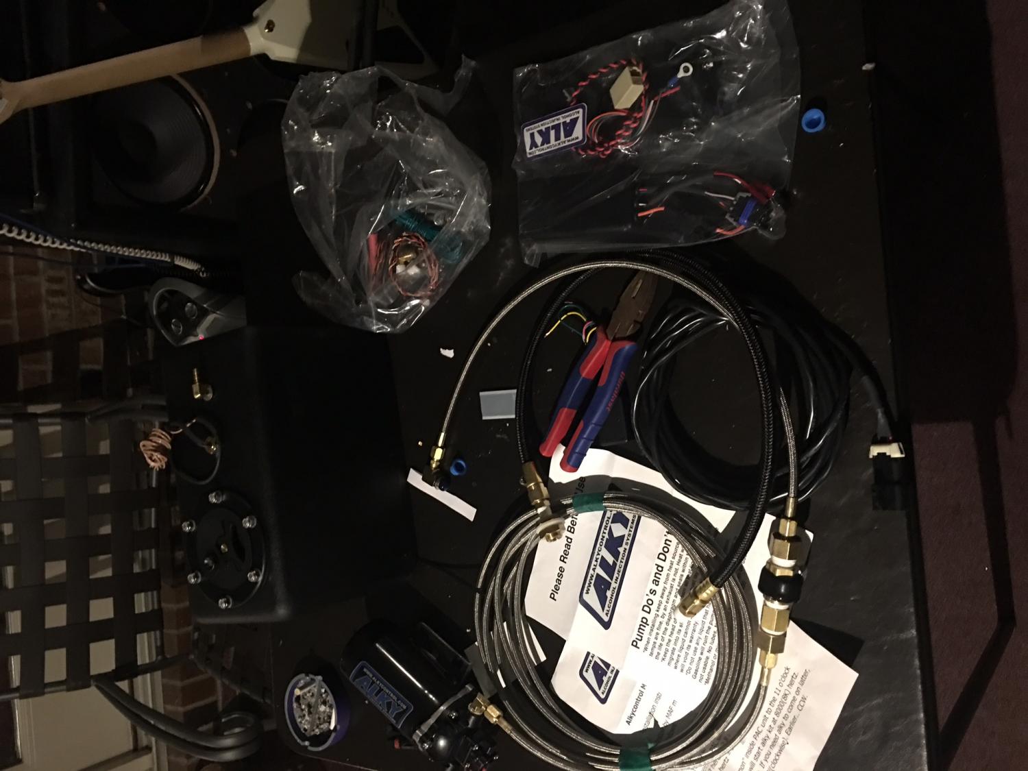

Got the alky control system in and it's nothing short of impressive, even after hearing how impressive it would be.
