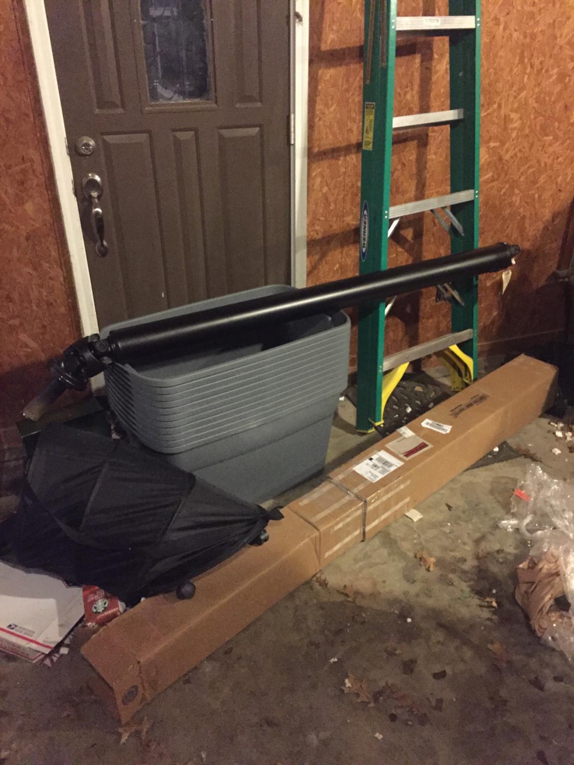

PST was dragging their feet getting me a quote so I called up Tom woods and spoke with Carrie. He lined me out with a 4" dom double cardan shaft with solid non greasable spicer joints. I forgot to ask about critical speed and when I called back to do so Mr. Woods himself answered and happily answered the question. He said 4000 rpm which sounds heavenly!

Here's a quick pic of the shaft. It's a heavy joker but should be rigid.
Truck is going in the dealer Thursday hopefully they will fix my motor if not 416 stroker time.
What gears you have? 4k critical speed seems a bit low for a 6 speed. I'm guessing this isn't carbon fiber either.
That 4K was with a safety margin factored in.
I'm running 3.23 gears and 37" tires so they make for a lower driveshaft speed
I'm running an 8 speed

There are different ways to calculate driveshaft speed but my way is to take tire revs per mile and multiply that by axle ratio. that is ds speed at 60mph
So my 37" tires =560 revs per mile
The axles turn every 3.23 turns of the driveshaft
So at 60mph the driveshaft is at 1808
At 100 it's @3013rpm
At 120 it's 3616
At 150 it's 4520
I don't foresee ever going over 140 on 37's
Hope my math is right lol

How much was that drive shaft?
I believe the shaft was 650 and as far as my engine I'm guessing a valve munched a piston
