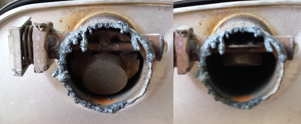

Well, "Adjust" may be a stretch :) Take a look at closely. There aren't any screws, etc to tweak it. But if the spring has jumped out of the track or broken, it'll rattle like mad. The shaft really doesn't have any bearings installed where it passes through the pipe, so if the clearance is excessive, well the flap & shaft will rattle against the pipe. If it's minor, then a cold punch and a hammer can close up the clearance and stop the rattle. Otherwise, may have to replace. The flap itself should be FIRMLY attached to the shaft. If the welds are broke or shoddy, could be flopping around. Etc etc. GM has replaced a ton of these for rattles on stock vehicles, which is probably their best approach. Just comes down to questionable and inconsistent quality from their supplier.

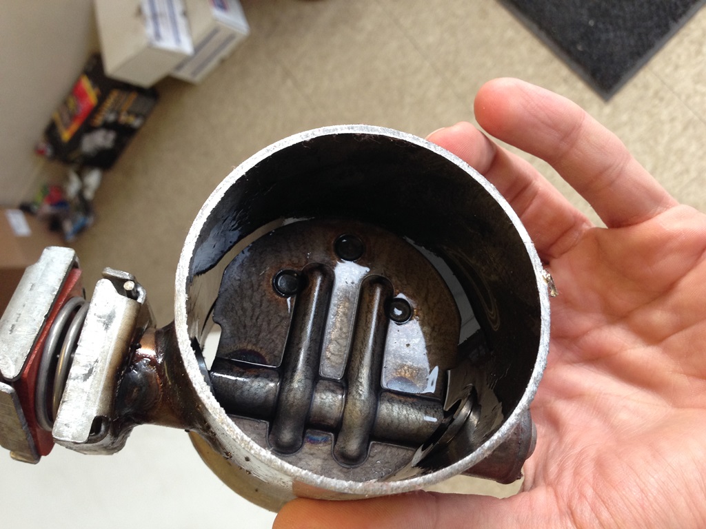

This look like a high tolerance piece? But notice one has some hi temp rubber under the spring? Some have tried this to eliminate the loose spring rattle. Takes up the space and adds dampening.

OK. I see the rubber you are talking about on the inside of the bottom picture. It could also be the spring as you noted.. I will look to crawl under it tomorrow and see what can be adjusted.. Unfortunately for me I don't have an ability to cut it off without the help of a muffler shop.
What part are you saying to look and punch with a hammer?
Are you saying the major spring that is part of the rotating system on the outside can be out of place or broken?
And maybe to be clear for me what are the best items that I can look at from the outside.
