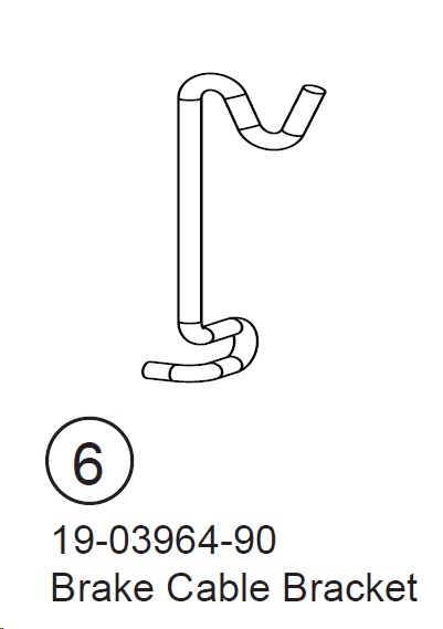

Not a 100% sure, but it doesn't look like your using the e-brake relocation bracket. Did you do the install?
the bracket that came with my Amp steps is solving this issue for me.....I've never had the issue, so more like preventing it. AKA doing its job :)
My local 4 wheel parts shop installed them for me, but I will bring this up to their attention today when I take it in. Can you send me a picture of how the bracket should look installed to compare?
Thank you. Do you know if the brake linkage is mounted against the frame to? In my video you see the linkage being slipped up from the steps hitting it when closing. If you can send me more media, maybe a video clip that will be GREATLY appreciated! Thanks!
Get the bracket that is shown above. It mounts directly into an existing hole in the frame as shown in the picture above. My AMP kit came with it and it has been installed for almost 2 years on my truck without any e-brake problems.
Thanks, I'm in contact with amp and they are working with me, they are very helpful
UPDATE: I had the shop who installed the steps "4 wheel parts" take a second look. They installed a longer break cable bracket, and wahlah!! Like magic problem solved! Happy camper!
