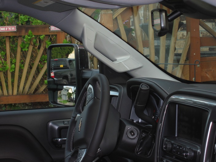

Driver's side grab handle mod install - used a credit card to pry the rubber door jamb seal back enough to grab the plain cover with my fingers - popped right off - no tools - no touching the easily soiled headliner. (Why don't they have black headliners). Then just a matter of lining up the holes - thread on with a 1/4" nut driver as far as possible. Then carefully tightened with a 1/4" ratchet, being sure to protect the windshield from the ratchet handle.
Was thinking I would only use it for getting out - but it seems handy getting in too - no wonder they put them is HD's...... Now I am grab handle symmetrical. :thumbs: :thumbs:
Was thinking I would only use it for getting out - but it seems handy getting in too - no wonder they put them is HD's...... Now I am grab handle symmetrical. :thumbs::thumbs:

Great mod. I put one in too. Not only functional but as you say looks symmetrical now too!

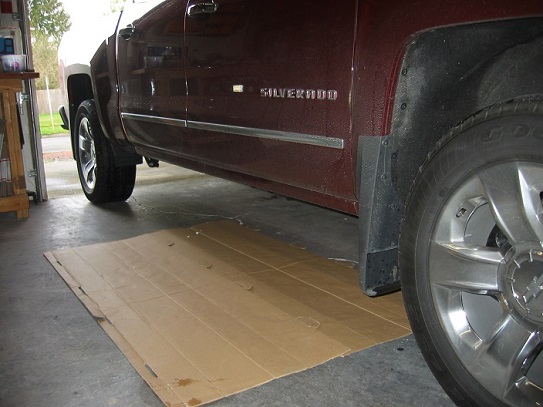

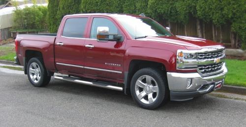

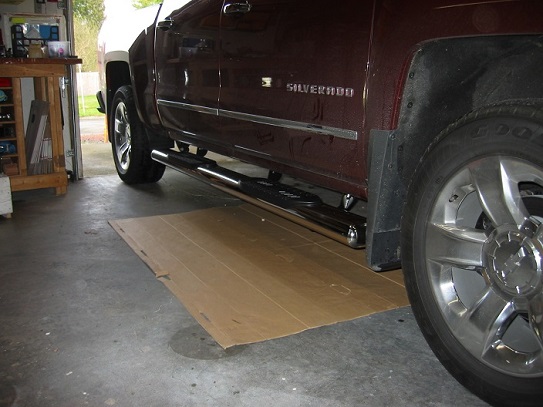

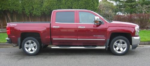

Stumbled onto a good buy on Tuff-Bar stainless steel steps aka nerf bars - and discovered they are actually re-branded Westin steps. They even ship from Westin - same brand stainless tube step I had on my 2007.5 and very good quality. Either eBay or Amazon seem to have the best prices. I bought these on eBay from JC Whitney on Tuesday, and they arrived today via Fed Ex. ($269.76 delivered).
I liked this design because of the welded end caps - rather than just plastic plugs like most a made. These surfboards are 6" wide! Easier for the young and old to climb aboard..... And adds a little more bling....... :pimp:
Install took 30 mins a side - nice to work with new parts designed to fit well. Would make a good career.
https://www.carid.com/tuff-bar/6-polished-stainless-steel-oval-straight-tube-step-bars-mpn-5-60273.html

Krusty, congratulations on your new truck...it's beautiful! I really like the nerf bars, too!
