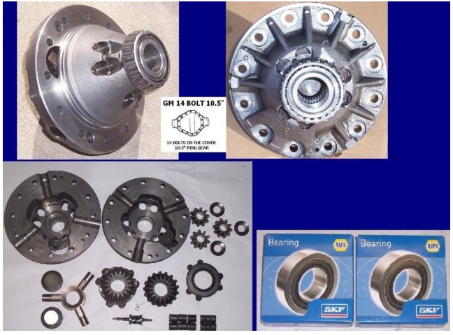

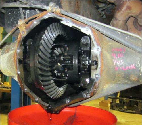

Here are a couple pics of what I was referencing to on the lockers.
There are some friction discs on one side in a small clutch pack. Some use carbon fiber discs now..they do not need special additive as the pressure on them with the pin system is greater than the old spring types for lock up.
This is a break down of a 2002( estimate) and up 14 bolt full floater locker ( 2500-3500HD)
a 14 Bolt FF "OPEN" Rear will have 4 Pins in it, Not 3. You can add a positrack to the 4 pin open rear if needed.
This is the older style locker Basically a car type posi with a couple rocking flanges on the carrier to lock the rear in forward or reverse. This system cant take a beating, and snow plowed trucks will ruin these fairly fast.
