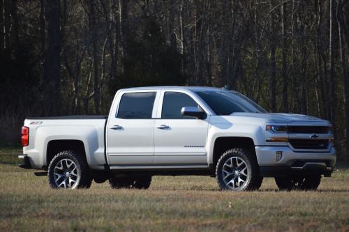

So I know the wheel spacer dilemma has been beat to death on these forums, but i have a SPECIFIC question here, and am hoping someone has experienced the same issue as me -
2016 Silverado z71 - stamped steel UCAs
OEM 20" GMC A/T wheels
33x12.50r20 Toyo M/T
2.5 inch Level w/ Bilsteins
My tires rub pretty bad on my UCA's. I know my 2 options are new UCA, or Wheel spacers. If i go spacers, they will be BORA hubcentric spacers.
Now my questions is probably geared more towards GMC A/T owners that have used wheel spacers, but has anyone used the BORA 1" spacers on these OEM wheels? Are the pockets on the wheels large enough to where I will not have to trim the stock studs?
I have read that the 1.5"+ work with most stock GM 20's and NO trimming is needed, but 1.5" will make my wheels stick out much further than I want. 1" is even a stretch for me, but would be the absolute most I would want to go.....
Any opinions here? FYI - new wheels w/ a different offset is out of the question haha. I love these wheels on my truck. Please help!!
Definitely like the looks of that set up. I have the Bora spacers and I can't imagine the pockets on these wheels being large enough to accept the studs going with a 1" spacer but I don't know for sure.
