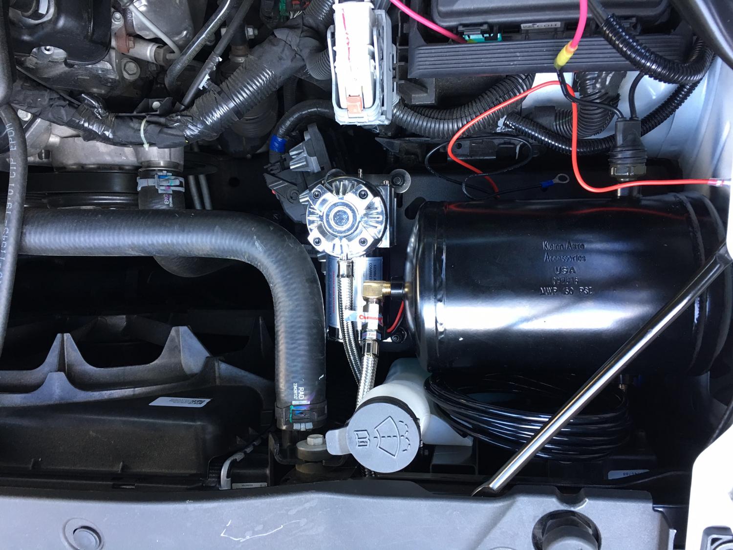

I found it very handy for my compressor and tank - new Kleinn Train Horns almost installed
I don't have a tank, but I mounted the compressor for my airbags there.
