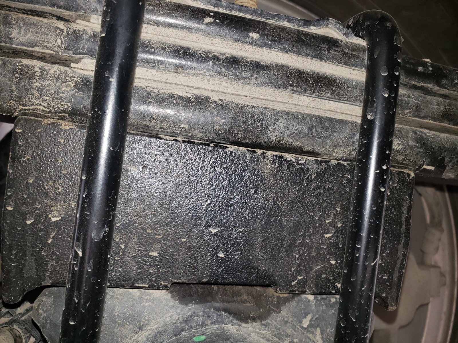

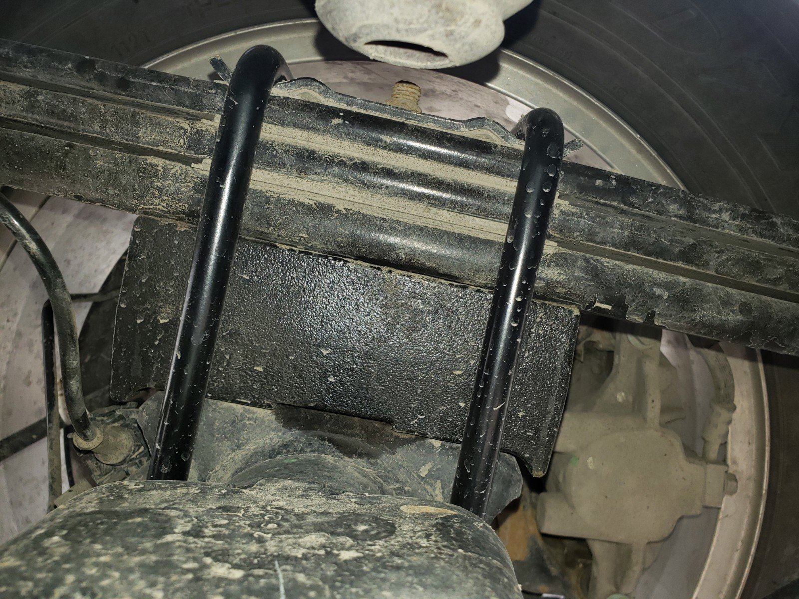

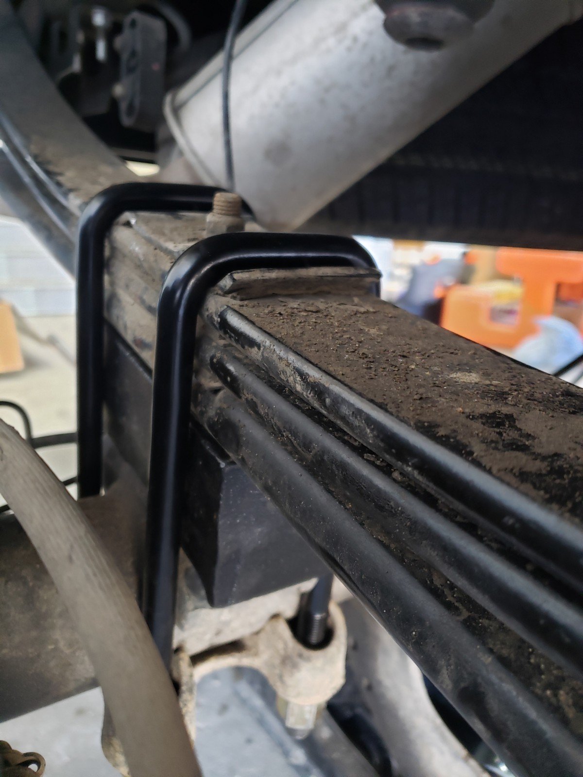

I installed readylift 2.25 rear blocks (# 66-3002) about 2 weeks ago. I can confirm they do have a very slight taper which you install pointing the taper forward.
With the U-bolts tightened down, it appears to sit flat & flush against the leaf spring.
In the limited amount of driving since then, I haven't noticed any vibrations at all.
