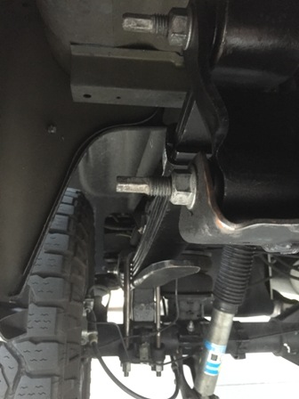

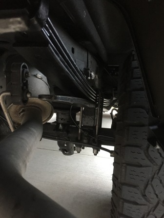

I got my 14 cc 2wd used 2 years ago, nice and quiet. About 6 months ago after overloading the bed with dirt I started getting creaks at low speed forward and reverse, a lot louder with any articulation. I think I have read most every post for leaf spring noise and tried everything.
Things tried that didn't work:
Pressure washing and air drying them
re-torque the U-bolts
TSB -#? for re-torque of the leaf spring bolts
white lithium grease between the leaves
marine silicon spray on the leafs, bushings and shackles
cut off the rubber edge of the bushing on the back above the shackle, added Delrin shims to prevent the rubber from rubbing the shackle
pinned the exhaust flapper open, in case I was getting noise there
removed the rear shocks to rule them out
having a friend jump on the back and push the bed all over, no sound could be heard
mounted a Go pro under the bed while driving to look for issues, at least you could hear the noise
greased front sway bar mounts and connectors, UCA and ball joint, just in case I was being fooled
Overloading the springs with the dirt didn't bend the leafs, but relaxed them a lot, the bed sat 1.5" lower after. So I figured after nothing working and getting so fed up with the sound, I ordered so new leafs from anywhere but GM, (ended up ordering from general spring KC, good price, bad shipping and bad customer service)
Got them installed!! Not a Peep!! It was like getting a new truck again!!! So excited that there was no more moan and groan. I felt embarrassed driving the truck around because it sounded sooo bad.
So new leafs fixed the issue for me.
One thing that stood out between the 2 sets was GM's bushings have the rubber over the whole side where the new ones from general spring KC did not have any rubber in the outside edges. (I really thing my bushing were slipping in the spring eyelet) Also the new springs are 5 leafs instead of 3.

Cost? Rides the same? Did they increase payload? Iv been looking for a new set
$129 each, kicker was the $130 shipping. I think the ride is close to OE ones, maybe a touch stiffer. They are capacity rated @ 2025lbs, I don't know what OE is rated for, so I don't know the difference.

Last night I clamped the eye bolt from the OE springs in the vice and made some up and down movements, it made the same sound as on the truck, just not as loud on the bench. It was the bushing slipping inside the spring eyelet. A lot more noise coming from the front bushing than the rear. I would think just swapping to some aftermarket bushings would have fixed the noise too.
