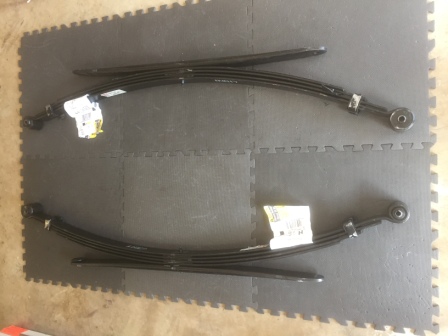

1999 - 2015 Chevy Silverado / GMC Sierra 1500, 1999 - 2010 2500 rear leaf spring, 2025 lbs capacity, 5(4/1) leaves
I also want to point out, I got the parts quick but for $130 shipping, cheapest. UPS did bash them around a lot, when I got them I thought they were refurbished. General Springs assured me that they are not refurbished.

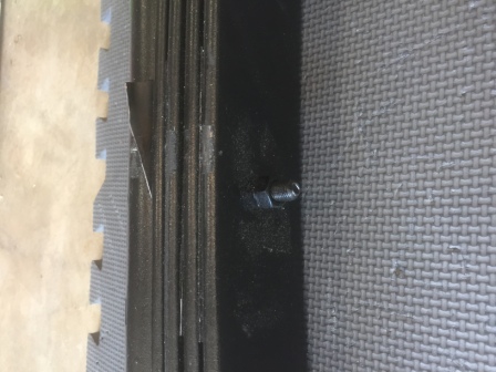

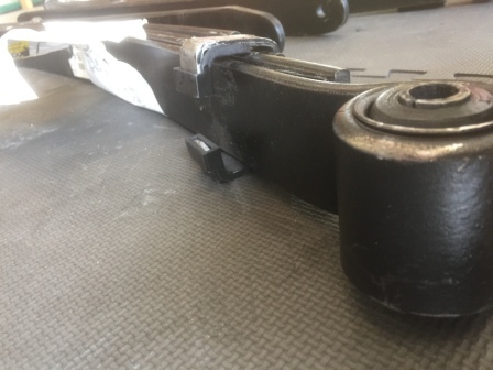

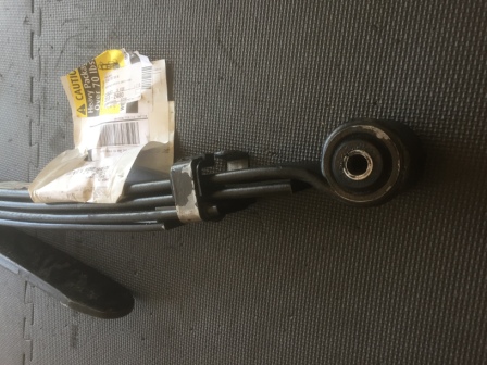

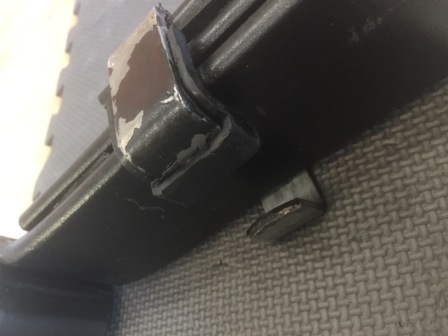

I had 3 of the square plastic pads missing, a plastic protector on the spring clamp missing, each leaf had 1 clamp that got bent out, missing 1 round pad from the overload spring, turned and bent shims between the leafs. Lastly some bare metal from handling.
All easy small fixes, but for ordering new springs I was very disappointed how they came. I cannot blame UPS for it, General Spring KC just slapped a label on the bare leaf springs. They really should have wrapped the eyelets with cardboard to at least help protect them and if they would have put cardboard or 2 straps around the middle to prevent the leafs from spinning/rotating on the middle bolt.
I had to send pictures of the springs to the company, it took them 2 weeks to get me an answer back about the missing parts, very little communication from them on what was going on. Took another week to get the replacement parts (I had already ordered new missing parts from online since I was getting so upset being left in the dark).
I easily add the missing pads, hammered the 2 bent clamps back around the leafs, and hit them with rattle can black to cover any bare metal.
Maybe it was just my order but I was very disappointed with the lack of any protection during shipping on the springs, I felt the customer service had to be the worst I have every dealt with (just total lack of communication and the time to get replacement parts for the missing pieces).
I would still order again from them because the price was right (also looked at skyjacker but $300 for each) and they are not OEM spring.
If you do order from them I really hope you have a much better experience.

Here are the emails and time frame to have the issue corrected and their response. I received them on Mar 9th. I'll post a few pictures too
Mar 10th -
Hello,
I received my order yesterday (below is the order shipping notification) and was shocked at the condition of receiving my new leaf springs. I am attaching pictures in this email for your viewing too.
The leafs are missing 3 plastic square spacers from between the tips, missing 1 protector from the edge of the clamp around the leafs, missing 1 round rubber pad from the overload spring.
Other things that I am not happy about since these should be new springs, 2 of the clamps will need to be hammered back around the leafs as they are spread, missing paint, i am guessing that is why 1 of the protectors is missing. One shim between the overload and leafs will need to flattened back out and aligned back to the pack, as it has turned and been folded. There is paint flaking off the rubber pad on the overload leaf, why is it painted. I really feel like I just purchased a "partly" refurbished leaf spring set when I was expecting new.
Please let me know what you can do to help resolve my issues.
