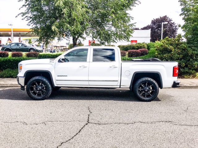

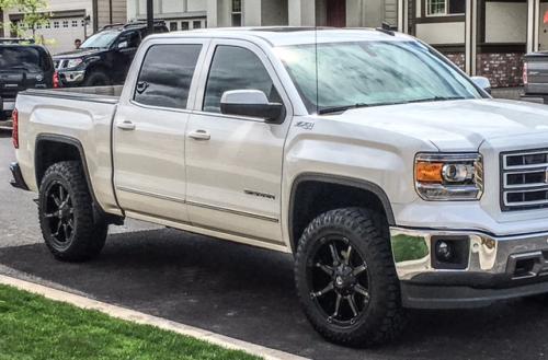

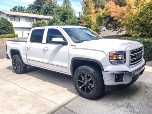

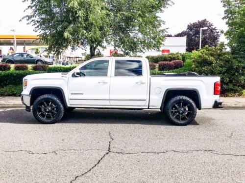

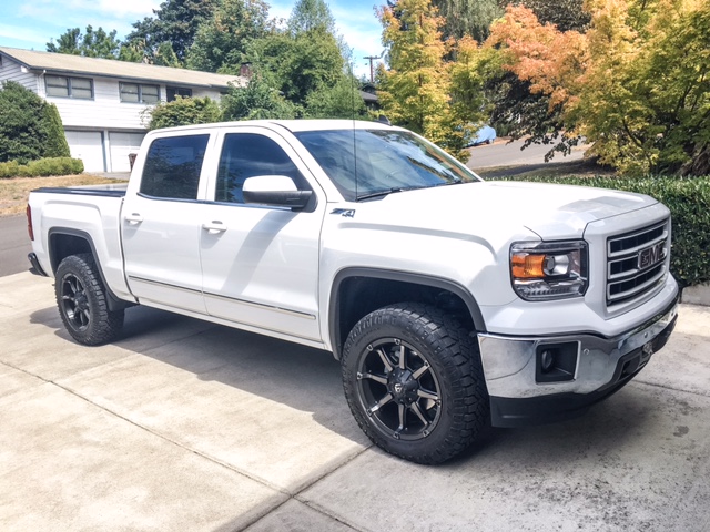

Bilstein 5100 shocks, says 1.8" lift but it gave me 2" up front
I have 20 x 9 wheels with 275/60/20 duratrac tires (33's)
Any rubbing? I have the 285/60r20 duratracs for my stock 20s to go with a 2" level thinking it shouldnt rub from what others say
My wheels are +1 offset Stock is like 27 i think. So my wheels poke outwards more than stocks. you might be fine it barely rubbed on one side just on the fender well liner. I just drilled 2 little holes and used black zip ties to pull it back to the frame. No more rub. To do this search the forums about zip tie liners. really easy and you cannot tell at all.
