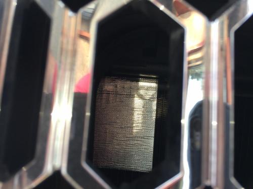

does anyone have a good picture of the re-designed condenser? did those who have got the fix have a (about) 4 inch by 4 inch reflective patch in the top right corner of the condenser?

That's interesting. I don't have that on mine. it's a whole new unit.
mines new too just not sure if it's the old design or new one. then the "patch" is a whole other level of confusion

My condenser was a 100% replacement and has the silver square area like shown up a few posts.  I know they didn't patch mine, so maybe the new design is to strengthen the corner?
