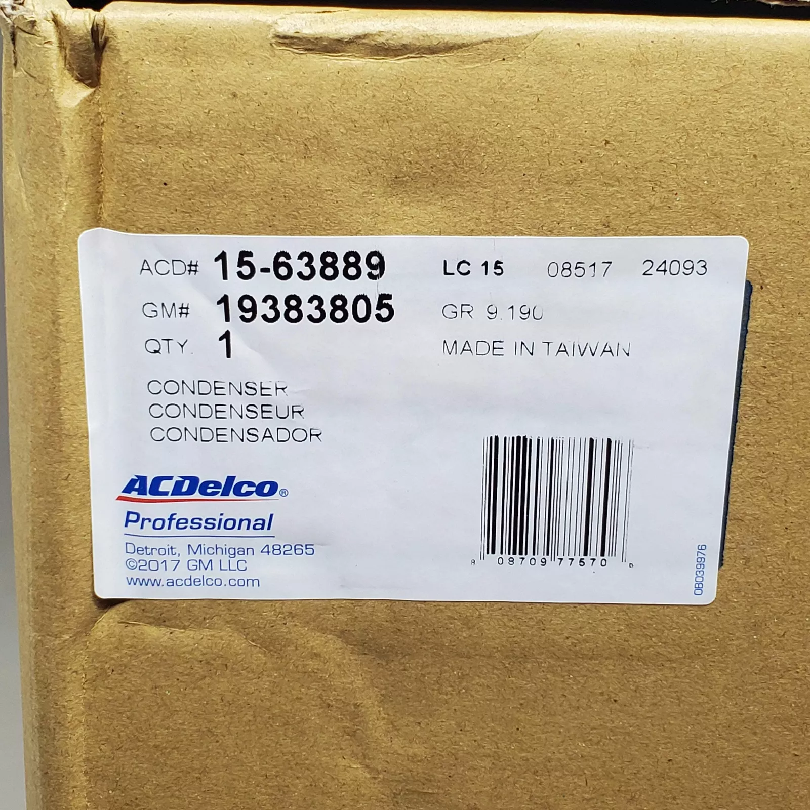

Add me to the list of leaking condensers, 1st 80 day in South Carolina and no A/C. Took it to a shop and they said it had a slow leak, with dye it was leaking right from a weld on the condenser. I need a new one, called GM, was told there is no issues on a 2016 so no help there. I ordered a GM P/N 19383805 and a couple of seals. Guess I will tear into it when I get it.☹️
Truck is a 2016 Silverado LT Z71 with 75,030 miles

The swap was good, had it leak checked and serviced, I have cold air coming from the vents again. What a pain in the a$$ to change out this condenser though. I wanted mine fixed right.
