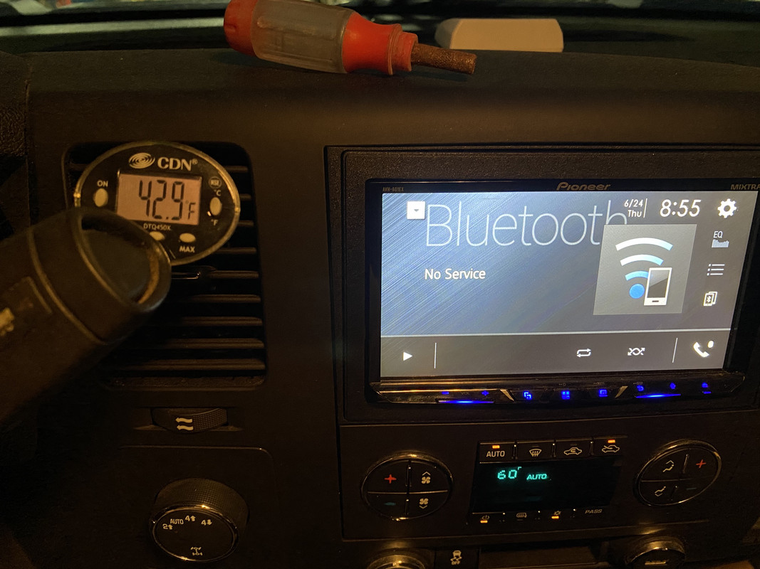

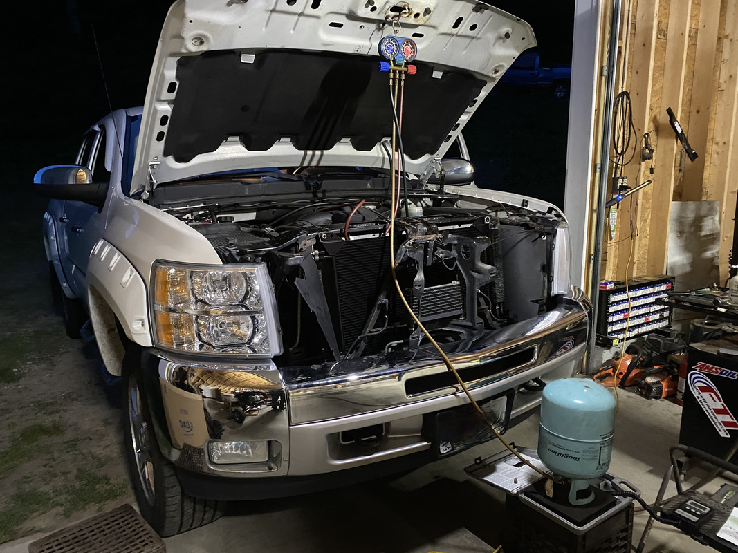

Just did this job on a '16 Sierra. GM can't seem to get ANYTHING right these days. Can't say I'm surprised. I'm still dealing with low bidder junk parts on my '07 Silverado 1500 at 113k miles. Tranny failed at 103k. Rear end at 97k. The clunk that has been there since day 7 has become progressively louder over the years. Something tells me the source is about to reveal itself any day now ... :mad:
But back on topic ...
Customer wanted cheap, since this thing has been a money pit for him since the day he bought it (Gee, sounds familiar ... shocker!) - he traded it for a Ford (Not that they're any better). Used UAC brand from RockAuto. My opinion? STEER CLEAR! Chinese garbage! Took A LOT of bending and tweaking to get the piece of crap to fit right. I wasn't too happy during this install!
Thankfully the job is done, A/C is ice cold, and this headache has moved on to someone else (Unfortunately for them).
The 21st Century automotive industry for ya.
