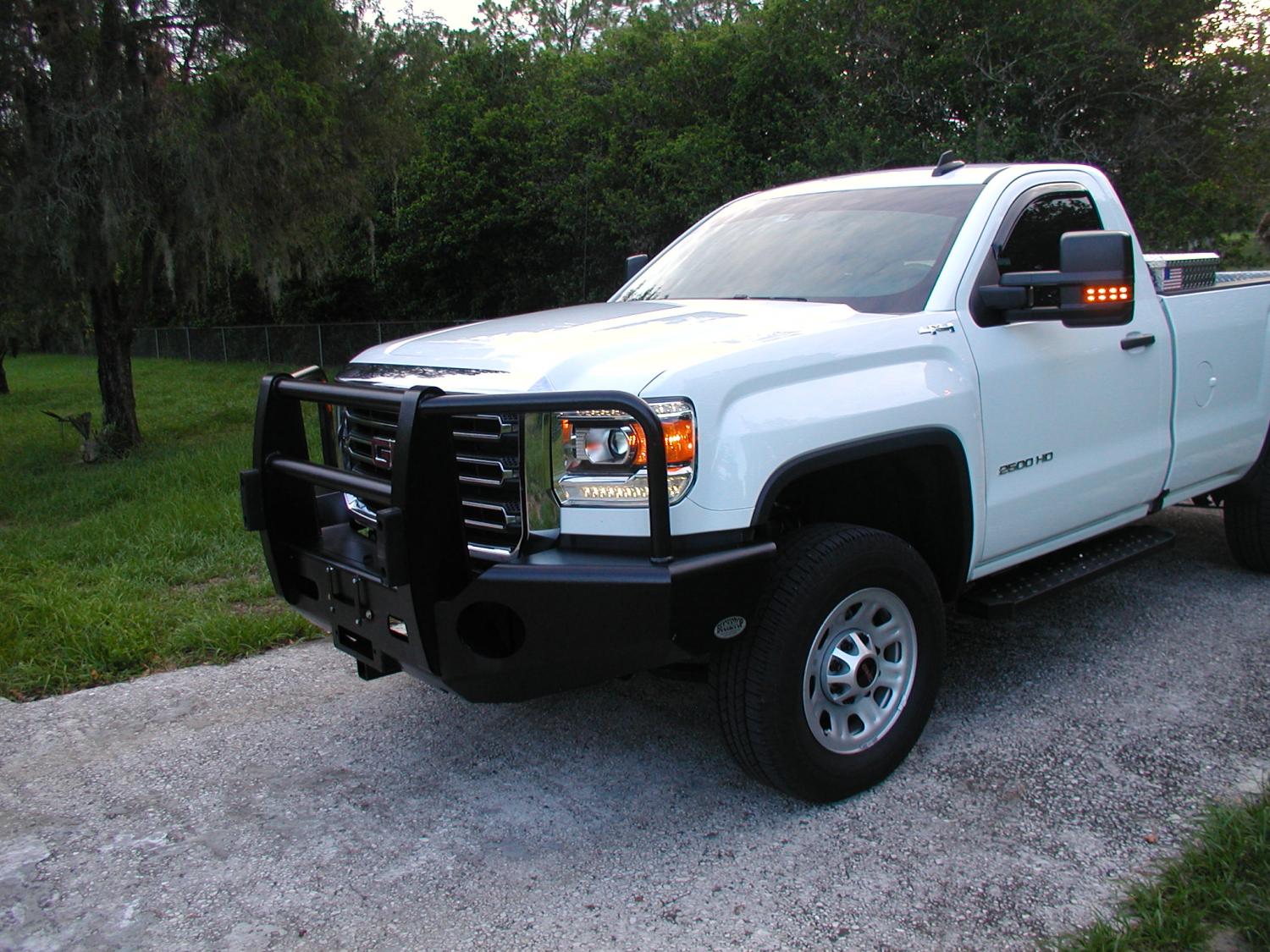

Here's the bumper in question. Got impatient, installed it before buying a winch, doesn't really sag out the front, but i can feel it overwhelming the stock springs and shocks going down the road at speed. Still looking at these torsion bars and better shocks to help control the extra weight.
