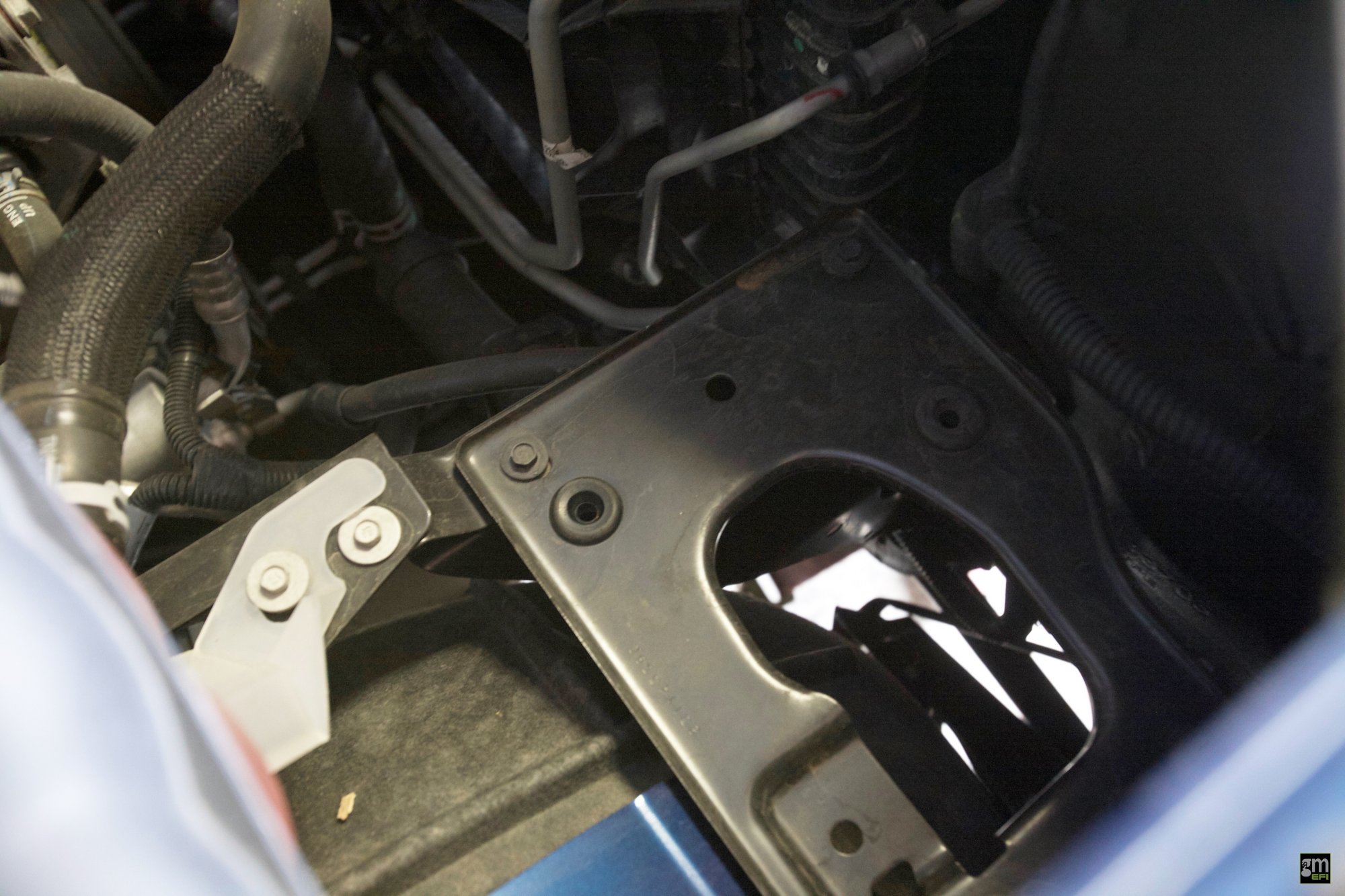

Everyone is saying the stock intake is a cold air intake, and I'm not sure why. There is no outside air being fed into the fender where the intake draws from. I've looked, the only opening into the fender besides the one for the intake is a cut out by the battery. There is no air source from in front/beside the rad or anywhere around the headlights. Its all closed off. One could argue the air might be a little cooler in there? But regardless the intake is still drawing air from the engine bay.
A cold air intake would draw air from underneath the intake box. GM actually use to do this. There was an intake box with a perforated bottom so it could draw air through that plate. you can find that exact metal intake bracket with no bottom on trucks from the 90's. The 19's now draw air from the front of the truck above and just before the rad.

But historically a, "cold air intake" means its drawing air from outside the vehicle. People don't think of what temperature sensor's are reading when deciding whether or not it meets that designation.
The stock unit does draw air from the engine bay. Many manufactures draw air from outside the vehicle like the new Silverado, or in some applications almost like a ram air intake. You can paint it any way you want it, k2xxx don't have a, "cold air intake".
You ever run a thermocouple from under the hood of a K2XX? What to guess who has?
I need it explained to me like I'm five how the IAT (mounted between filter and TB is nearly ambient) but under hood temperatures are significantly higher if the inlet air is in fact being drawn from a much warmer source?
Secondly 'historically' isn't a definition of a cold air intake. Cold air is and the factory unit does a fine job in the department. And aftermarket CAI can provide no colder air. Wait....they draw from the exact same fender hole!!
