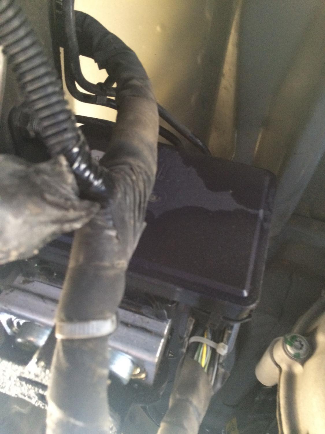

On Saturday June 22nd while driving on post, I noticed that my brake warning on the DIC “Low Brake Fluid” came that some of the vehicle braking features were disabled. I pulled over and began looking for leaks and didn’t find any. Concerned, I called "Chevy Dealership A" in Missouri if I could bring the truck down. Once I arrived, they got my vehicle in and a mechanic found this: (See BRAKES 1, BRAKES 2, BRAKES 3 for images). The tech said this wasn’t an overnight issue and took some time to get to this point because there was rust on the frame rail. The service advisor told me that he would get the part ordered on June 24th and that it would arrive on June 25th assuming no shipping issues.
On June 25th I arrived at the dealership around 2:30 PM to see if the truck was finished with the repairs. I spoke with the tech that was working on my truck and stated that the frame had been sprayed with a new liner that would cover up the rust and prevent it from spreading.
Issue # 1: NO SANDING WAS PREFORMED ON THE FRAME RAIL TO REMOVE THE RUST THAT WAS PRESENT. THE RUST WAS JUST COVERED UP WITH A NEW BLACK SPRAY LINER.
I looked underneath the vehicle to find that the ABS Module, the part that was leaking, was removed and the spray painted area was drying. Once the paint was dry enough to work with, the new ABS module was installed and the brake lines were reinstalled per factor manual and torque specs. However, during the brake bleeding process, the brake lines begin to leak again from all over. The tech had to use all of his force to re tighten the lines to stop them from leaking. Since the brake lines leaked on the frame rail again. All the paint product that was used peeled off and had to be replied… Which looked like ass after it was done, because the ABS Module had to remain in place while the paint was reapplied.
Issue # 2: BRAKE LINES CONNECTING TO THE ABS MODULE WERE TORQUED DOWN EXCEEDINGLY FAR PAST FACTOR SPECS.
There is a reason why you don’t over torque things, and why there is a torque spec in a manual for this type of repair…. The Tech literally tightened all the lines down until brake fluid stopped leaking... Which was forceful enough to bend the ABS Module bracket...
Once everything was buttoned up the Tech tried to reprogram the new module to trucks internal computer. The module failed numerous times which ended up requiring a new ABS Module to be installed.
June 26th the 2nd ABS Module was ordered.
June 27th the truck was repaired and no further issues have been noticed.
Now I am paranoid about the brakes leaking because of Issue #2 and I keep a rag in the truck and check for brake wetness after driving the truck.
