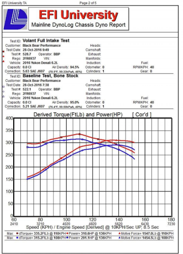

This is from the Black Bear test they ran some time back. Admittedly I can't tell exactly what the min gain is here and you're 100% right in terms of gain in HP but the torque numbers are higher pretty much throughout the band (slightly larger toward the end, but still close).
Now, that said I did grab the best performing of the bunch and I'm talking about it with a heavy bias toward torque numbers. That said it's still gains across the whole band. Whether you actually are able to notice those gains or they are worth the cost is a totally different argument. The fact they are there proves it's not a placebo.
Edit: forgot to add image.

Yes, the Volant shows a healthy increase at roughly 2600 RPM, which isn't too far up the band.

One thing I didn't and still don't understand is how BB got 291hp on a stock 6.2, that's a MASSIVE drivetrain power loss. Hennessey got 362hp on the same L86 motor (420hp) which seems more appropriate for drivetrain power loss. That's a 71hp difference on stock power which seems huge. I've always trusted BB, but 291 just seems EXTREMELY low, which makes me question the results of the entire test:
