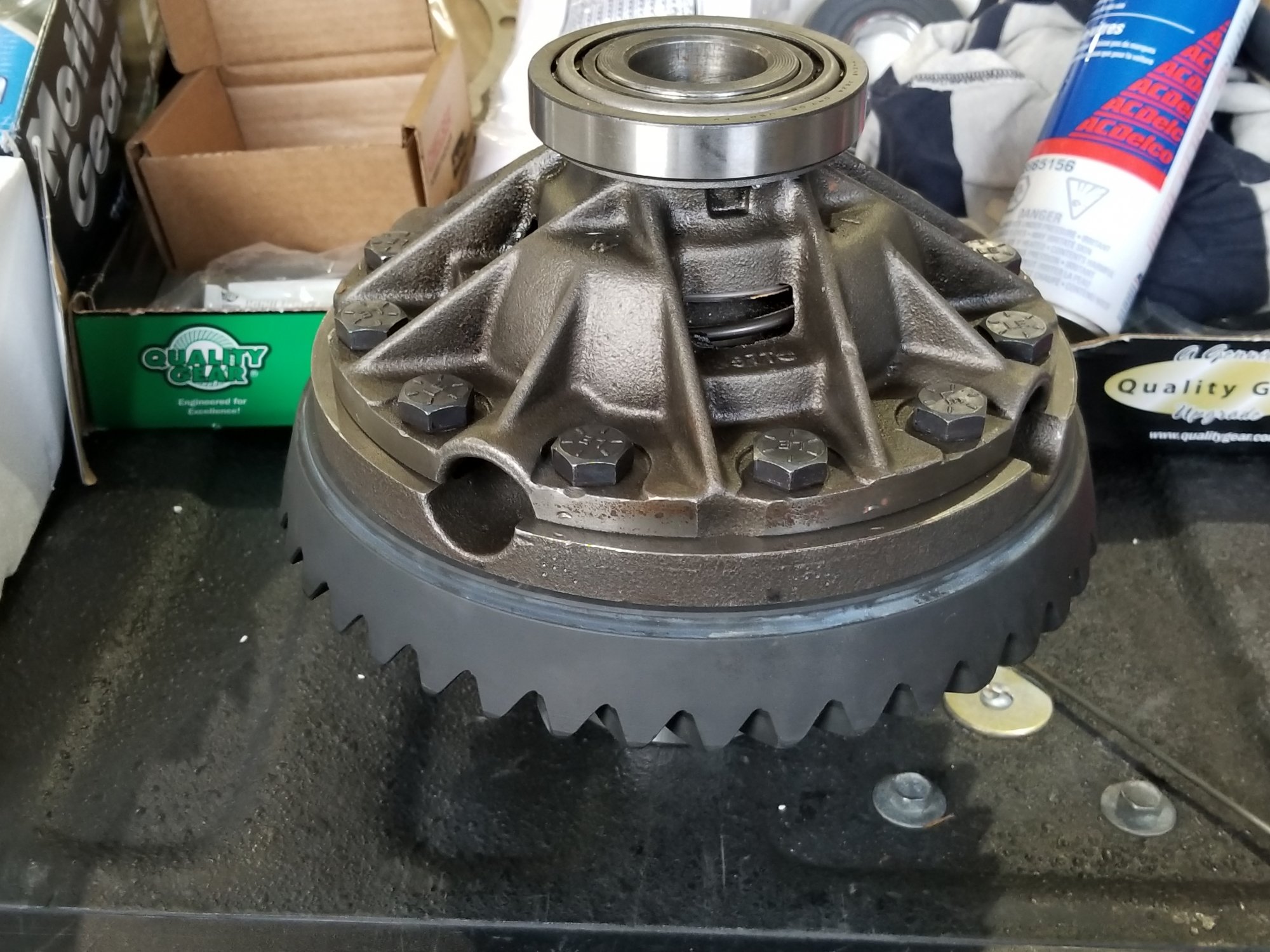

And of course..... the Gear Center sent me ring gear bolts for the rear as an extra because the kits don't send bolts for the 10.5".  Sure enough.... damn things are about 1/4" too long and the threads tear off the bottom of the them if you try and tighten them.  Even if you force them they do not sit down on the carrier.
The 14 Bolt has 2 lengths of bolts for ring gear attachment.  One is 2.1" long and the other is 1.80" long.  The reason is the carrier split and in this case since I am using a 4.10 and lower numerically carrier but running a 4.56 gear they sent me the longer bolts that normally would be used with the 4.56 and higher carrier.  Honest mistake but somewhat critical and I am glad I wasn't in the shop with this as I doubt anyone up here stocks the correct ones.
I will make them send me the right length bolts since it's there screw up and I did pay for them.  1.75" hardware store bolts would probably be fine but I might as well get what I paid for.
And yet another roadblock with my little plan.  The independent shop I am trying to get to do the job is saying they are not equipped to do so.  The lovely front differential I had no desire to work on is more of a pain in the ass than initially thought, or is it?  According to them and GM you need a carrier spreading tool in order to work on it.   The funny thing is that according any service manual you need this carrier spreader for any differential with a shimmed carrier.  That's a really big list and encompasses almost every diff made other than like the 10.5" and 9.5" 14 bolts.  Dana's, Chryslers, most GM axles, etc all call for it.
 Now I find this curious because I am not a novice to differentials and I see absolutely zero need for this "spreader".  The purpose of it is to open the housing to allow you to drop in the shim packs with the carrier and then once the tool is released you will have your carrier bearing preload.  Well I have never used a spreader.... sure have used a brass drift though and just hammer the shims and carrier in evenly with it.  I learned that method like 20 years ago and you use brass so you don't damage anything in the process.  This really begs the question as to whether these guys know what they are doing... kind of sounds like they don't.  Might have to find a new shop.
