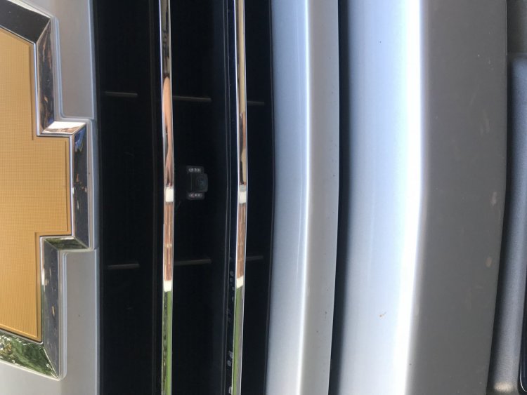

Lerbud, when you installed your camera, did you have any problems running the cables and was it a plug and play or did it require a visit to the dealer for programming?  Thanks for any help you can provide.
Don
All plug and play.  Hardest part was getting the cable through the firewall grommet.  You dont even have to run a power or ground as it uses the factory stuff.
Thanks Lerbud, that is $60-70 less than best I had found.

Update, I received the Echomaster Intellahaul front camera system.  Extremely easy install.  Just watch the videos on Youtube by Echomaster.  The hardest part was going through the firewall.  There is a rubber grommet, where the main wiring harness goes through, but there seems to be multiple layers to it and under the dash you can't seem to get your hand through all the mechanicals to even get to the grommet.  In about an hour or so it was complete.  The instructions state to put the camera right under the bowtie but I chose to go lower after what Jmiller11331 recommended.  All in all I am very happy with the result.
