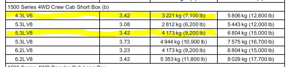

3 hours ago, Donstar said:
Weight, aerodynamics, gear-ratios, transmissions, wheels and driving habits all impact performance.  Heavy emphasis is placed on horsepower because it is a number we can easily compare.  A  relevant example of this is how my V6 truck is rated to pull 1000 lbs more than an equivalent truck with a 5.3  V8 and a standard 3.08 gear ratio.  Some will pay more for 70 extra horsepower that does less.  Arguably, the V8 sounds nicer when you're standing outside!
Perhaps we should compare apples to apples here. Gear ratios matter.
Great illustration of the point I was making.  Also notice the impact of gear-ratio on the 5.3 vs the 6.2.
And were back full circle. If it matters that much that you can pull the weight of Mt Evens up a 10% grade at 100 mph then have at it. I don't have that need and I'm not understanding why those who do wish ill on those that don't. Or as Elmer Fud would say, "KILL THE WABBIT"!!
