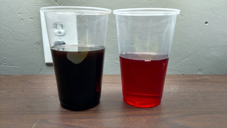

When I changed the fluid on my Sierra I used a transfer pump I bought at Harbor Frieght for around $7. I was able to get just about a gallon out through the dipstick. The first time I did this around 60,000 miles and did it 3 times about a week apart each time pulling 3-4 quarts. By the third time the fluid was getting slightly more red. I think I did it one more time and the fluid looked pretty good. Below is a pic of the extracted fluid compared to new fluid. I plan to do another extraction and then drop the pan and replace the filter now that I'm at 112,000 miles.
