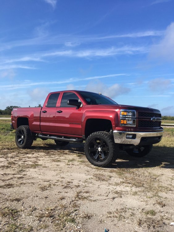

I had a 6 inch pro comp lift with 35x12.5x22 and stock rims. I put 1.5 inch spacers in the rear to bring the tires out even with the fronts.  No issues rubbing anything up front
