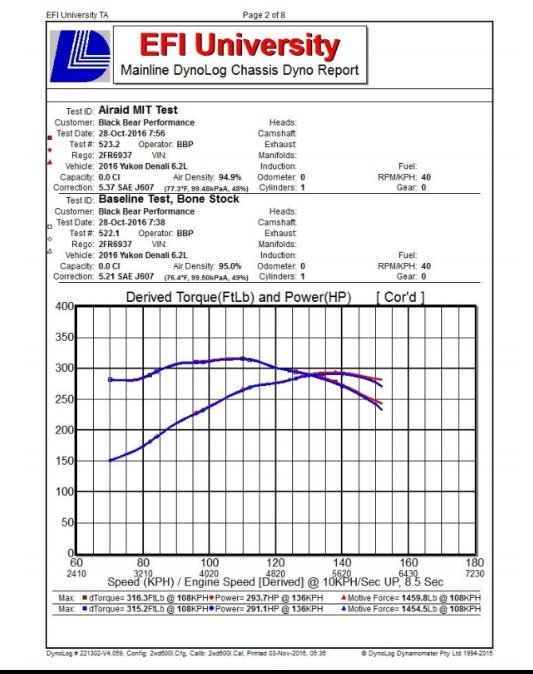

Here are the results of the test I did. Showed some power gains but actually slowed the truck down at the track. Don't get me wrong they look nice but from a performance standpoint a waste of money. If I didn't find an Airaid MIT for dirt cheap I would still have the stock intake on my truck. I would much rather put that money toward a tune, headers, or other mods that improve performance.

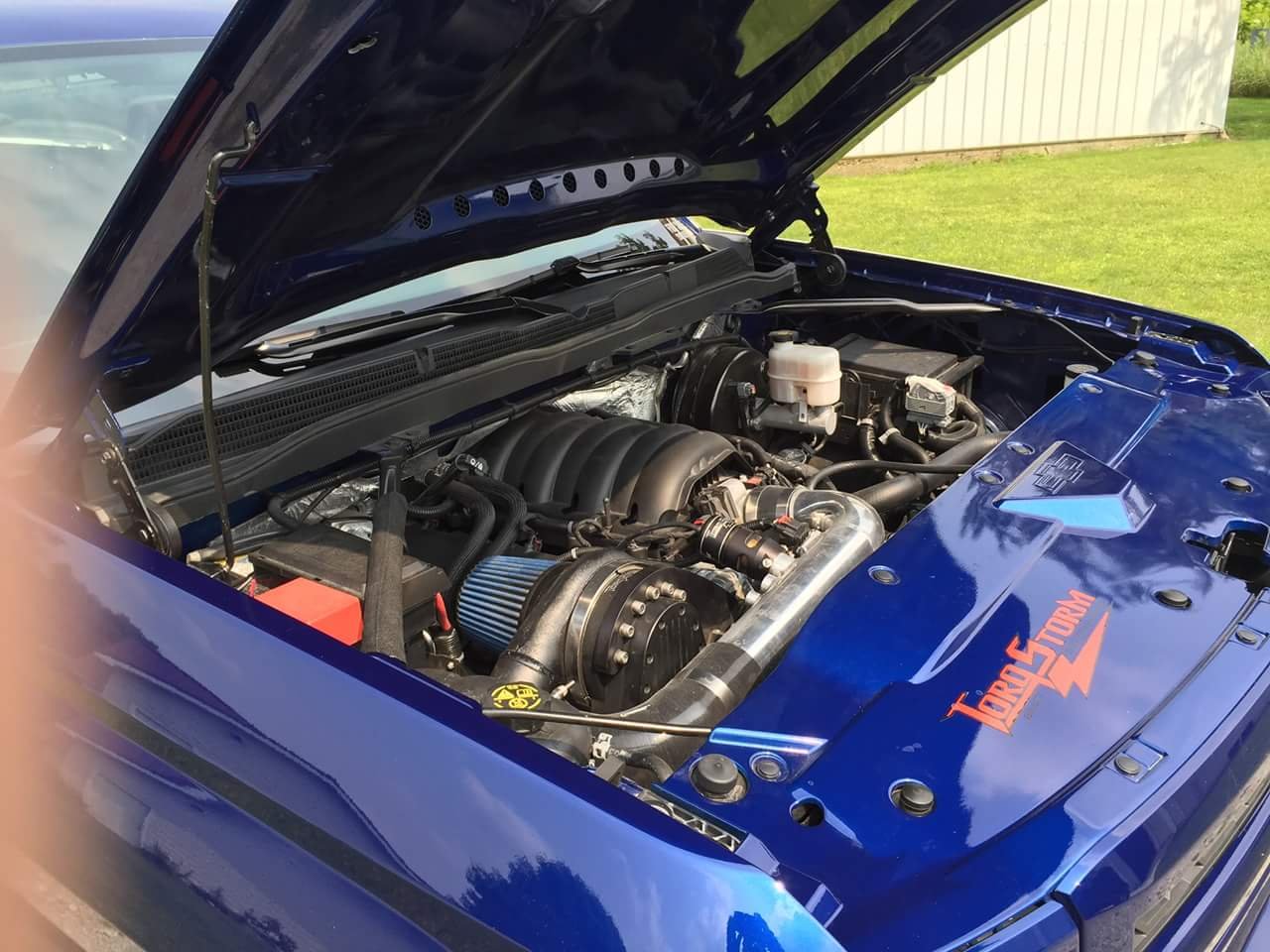

Once the Torqstorm kit comes back out for our trucks I will be getting that and making my own intake setup for the kit. Get some data and times how the kits comes and then data and times with the custom intake. Then finally get headers for my truck as well. Hoping for high 12s with just the supercharger and mid 12s with the supercharger and headers without meth or an intercooler. Moving on to forced induction and not looking back! :) Back to the main topic if I was to get a CAI again I would have gone with the intake you got prior to your post. Kind of disappointing to see what your dealing with after the high hopes I had with their kits being they always seemed to have great reviews.

The Torqstorm kit is 2,900 us and all other kits for the 5.3 are 5,600-6,300 us without the cost of being installed. Torqstorm kits however are sold as tuner off-road kits so they don't have to deal with emissions. I do look forward to seeing how the kit is first hand.

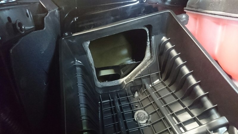

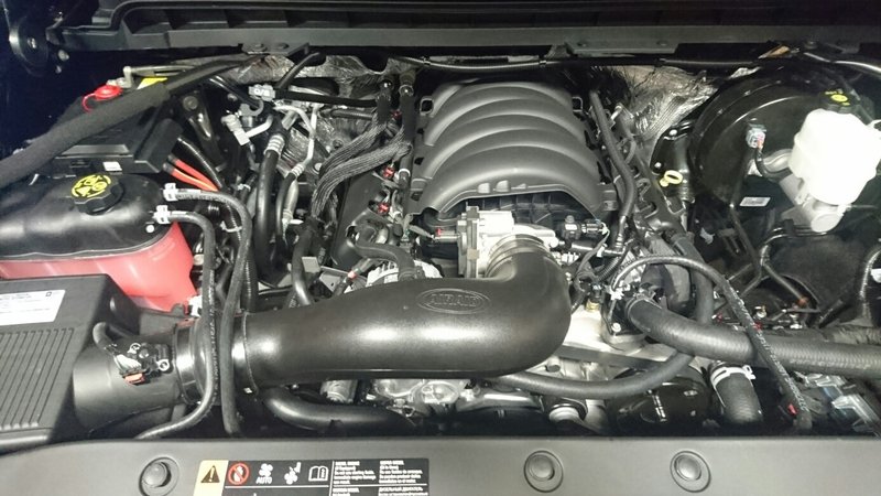

I always cut the side of my stock air box out, use a MIT tube and an drop in K&N filter.  it looks clean and works well on a mostly stock engine.  intake2.thumb.jpg.19cced1e5bd9612fe04d1137f518331e.jpgintake.thumb.jpg.79c04dad4acf23e6ad3e479d42aadd58.jpg

2 horsepower and 1 lb/ft torque past 5700 rpm? No measureable change below 5600 rpm? ANYWHERE.
Pretty much the definition of wasted time and money. I love the air density was 0.1 delta between test. Ends the discussion. :seeya:
