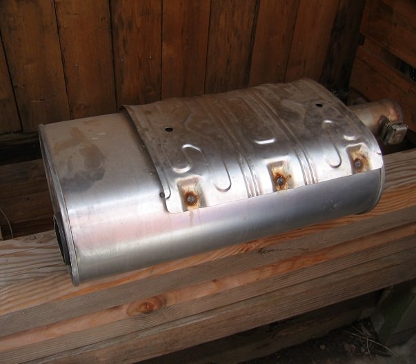

If you cut it off, save it because i seen some people looking to buy them.
You can just wire it in open position
