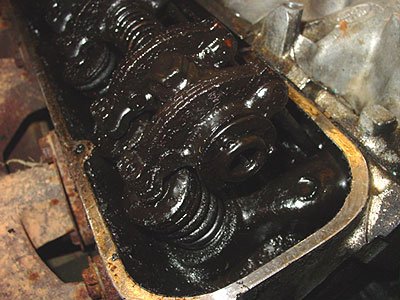

This is what oil sludge looks like. I don't think most people see this much anymore. It's caused by bad maintenance.
Some engines are more prone to sludge than others, VW comes to mind...good maintenance can still result in problems in some engines.
Steve
2012 2500hd
Steve
2012 2500hd
If you're talking about the old air cooled flat fours, maybe so.
Overall, if you check and change your oil regularly you won't get this.
No, I'm speaking to more current offerings with good maintenance.
My coworker is a Audi gearhead, his son had to have a newer VW and it was sludged up...it had all the maintenance records, routine changes and good oil. It had a leaking valve cover, and he pulled the cover and scooped out sludge.
So it can happen in a modern vehicle with good maintenance, if the engine is susceptible to that.
Steve
2012 2500hd
