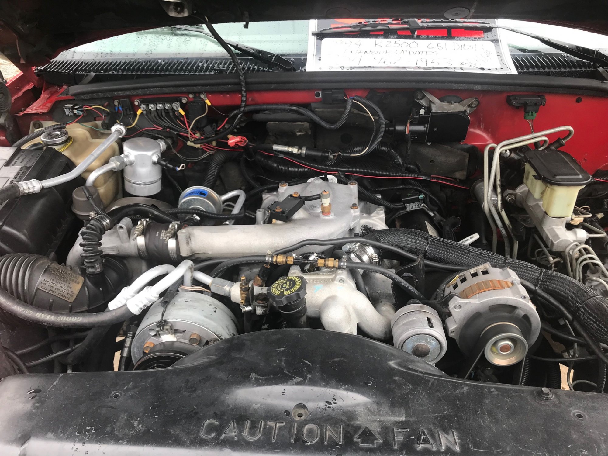

I’m not trying to get more output.  It is a Suburban after all and just want clean reliable transportation.  The wife didn’t care for the 94 3/4 ton with the 6.5 diesel, 4 inch exhaust, muffler delete, and motor tune.  That one I got carried away with when I bought it as a $2900 beater and started fixing this and that, then paint, then leather, then heads, then turbo, then ....  That was when Chevy really made a Suburban!

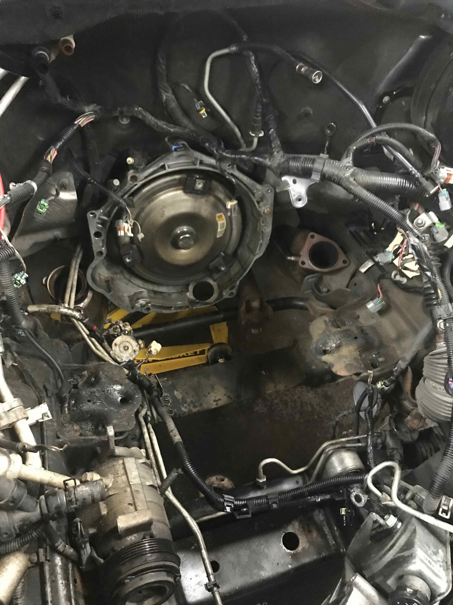

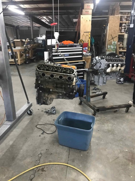

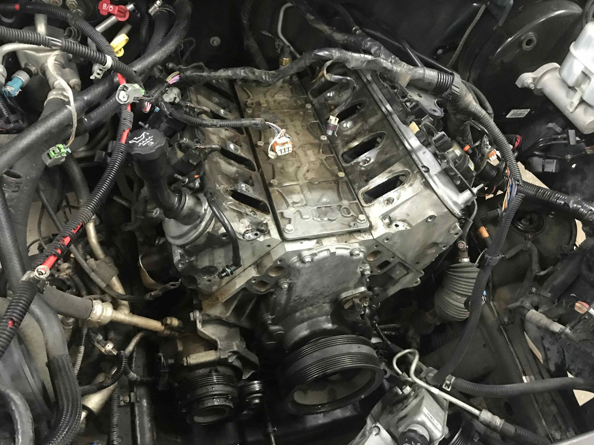

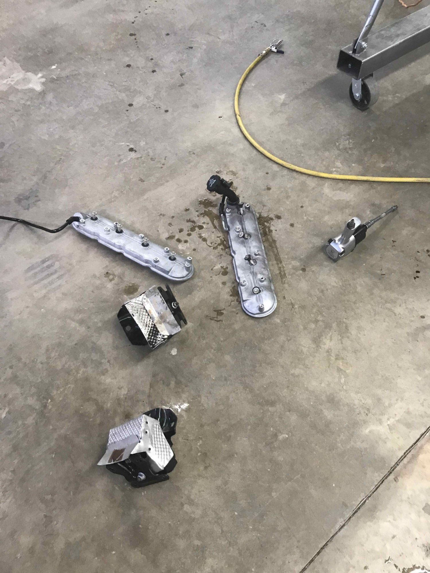

Today's progress off and on working between distractions.  Only hang up was an exhaust nut that wouldn't budge.  Hit it with an air chisel and it broke loose and needed a new nut but stud was fine.  The hot water parts washer is a dream....
Additional parts so far:
New starter $159.00
Cam Pos sensor $48
Nut $0.50
Front axle housing seal (found a small leak) $18.00
Front axle housing gasket $16.00
Front axle gear lube $15.00

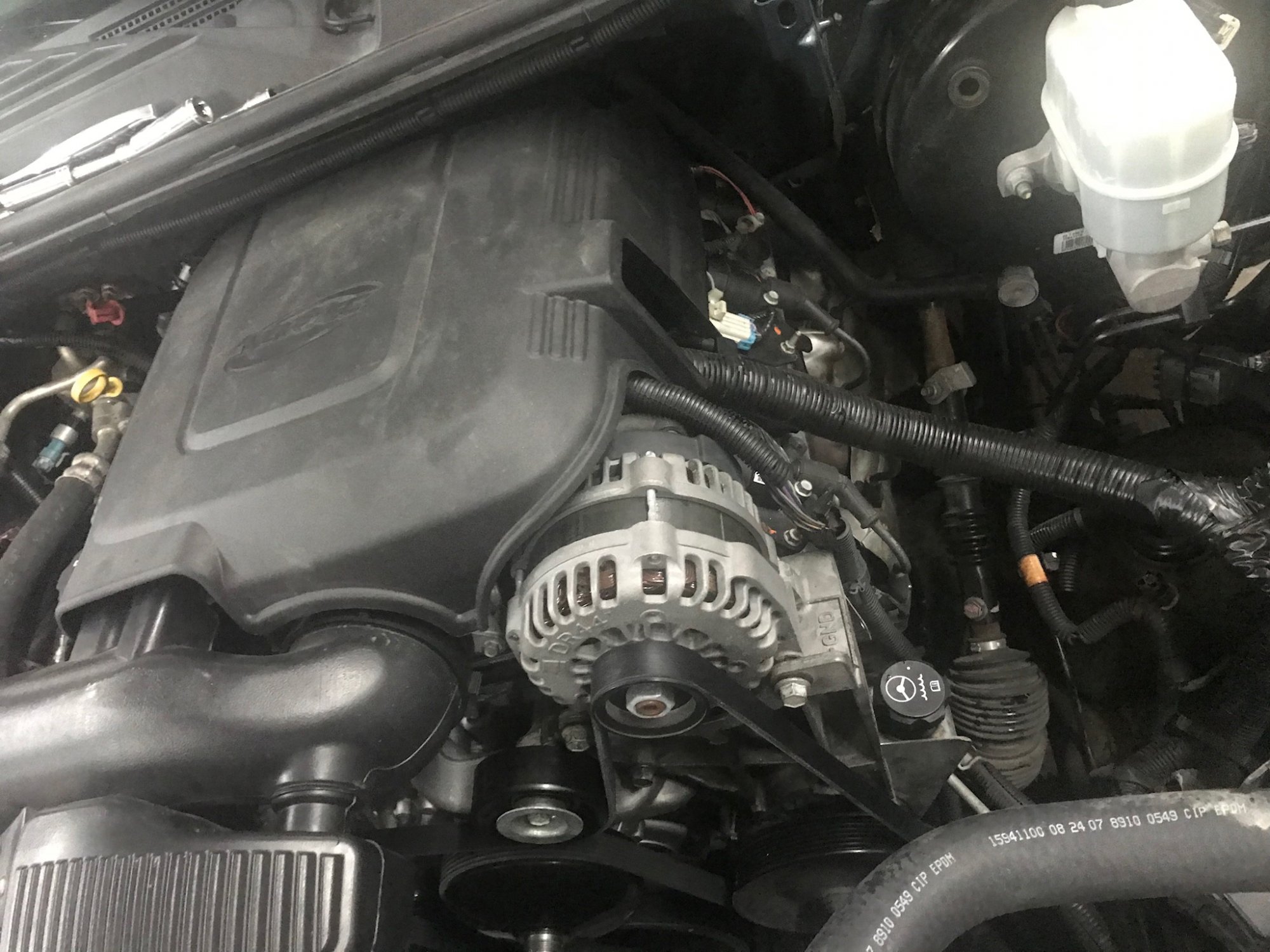

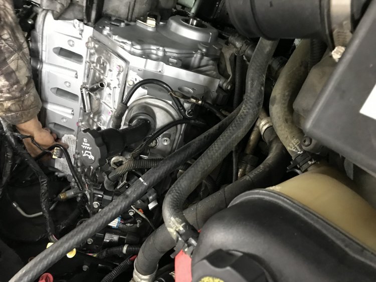

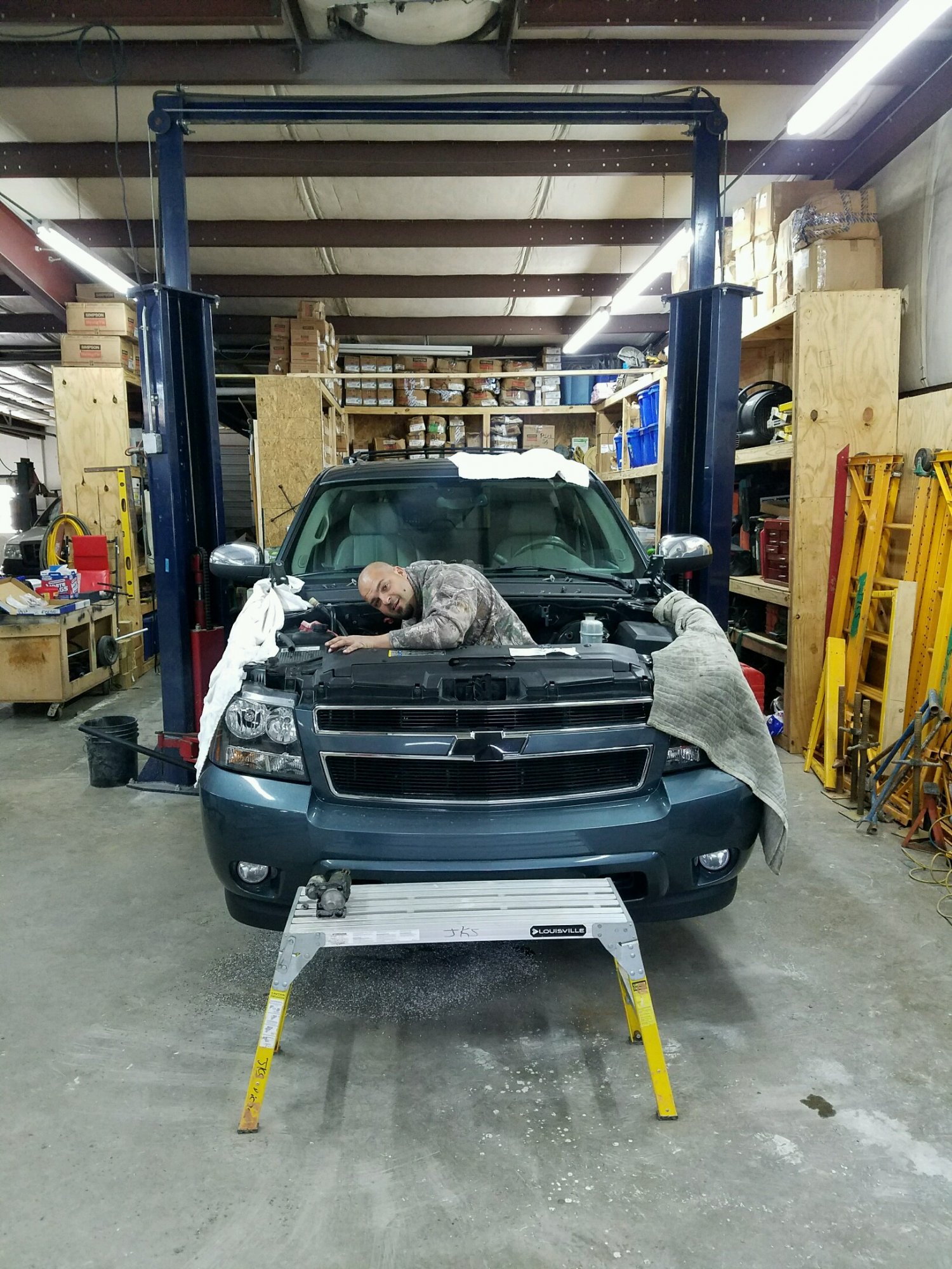

Today’s status, one more shop hour to go in the AM and time to start it up.
observations:
Remove the front differential for ease of access, easy to do.  Mine had a leaky seal on the right side of the housing and milky white gear lube.
Motor came out with HB on but remove it if you can because it will give you 3 plus inches of additional clearance between radiator and lip of the firewall.
Project is complete!
only hang up is we pinched the 4wd wiring harness and shorted the wires when we reinstalled the front differential.  Started up the motor and had CEL and transmission codes and all kinds of other ones.  We locate$ the pinched wires and repaired. Test drove and still had transmission code and the SnapOn scanner was not showing any live data and transmission was in limp mode. Of course check the fuses!  Blown transmission ignition fuse.
Motor runs smooth, no lag, and great oil pressure.  At idle half way between 40 and the gauge mark, under acceleration (mild) just above the gauge mark between 40 and 80.
