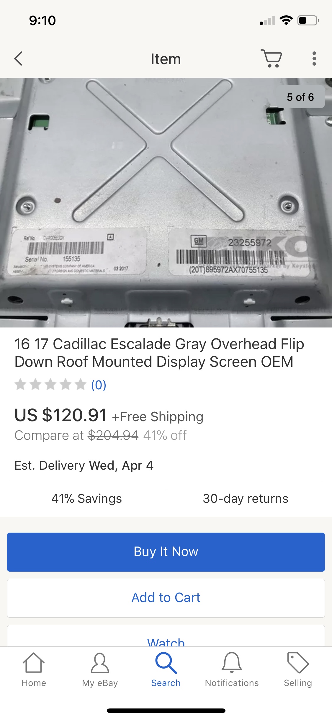

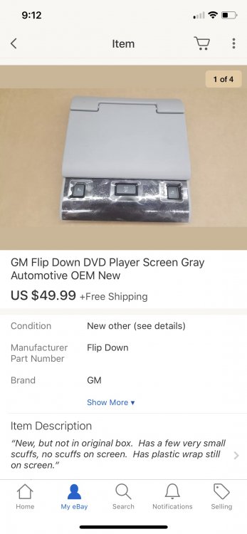

I’m trying to find the right overhead screen there are a few diff ones. Nothing for a 18 Silverado and the ones I’m finding all say without sunroof. I’m not sure what the diff is.
I don’t think that’s the one that’s gray I think the silverados are Shale on the upper. I only know that from the assist handle.
