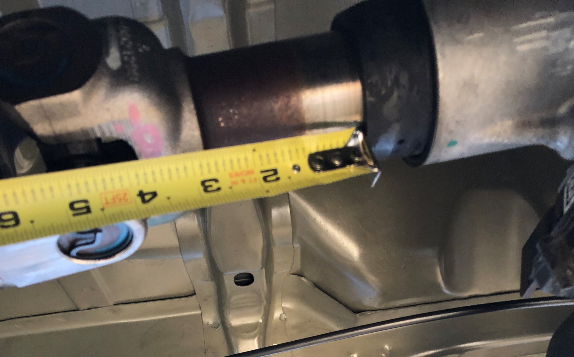

I’m having the same issue I lifted my truck 6.5 and I thought it was leaking from the seal but it leaking towards the end here is a picture.
I need help I don’t know what is the correct way to fix this.
You need a new driveshaft made to the correct length to accommodate your lift. The picture of your slip yoke shows a very dangerous condition that needs to be corrected.
I had one made to the correct length and this is how much of my slip yoke is exposed with all four wheels on the ground. 2e16cc72a4edd84e77648bdc8b90a40b.jpg
