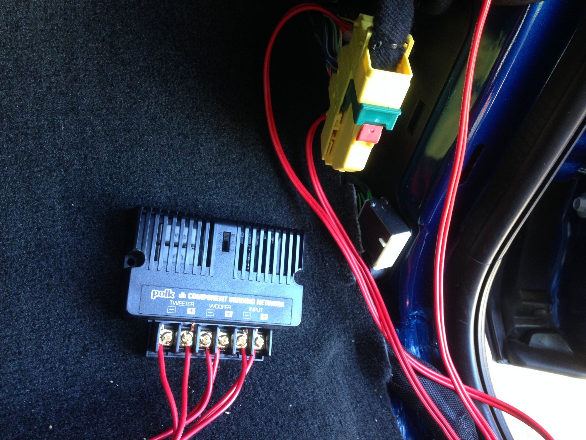

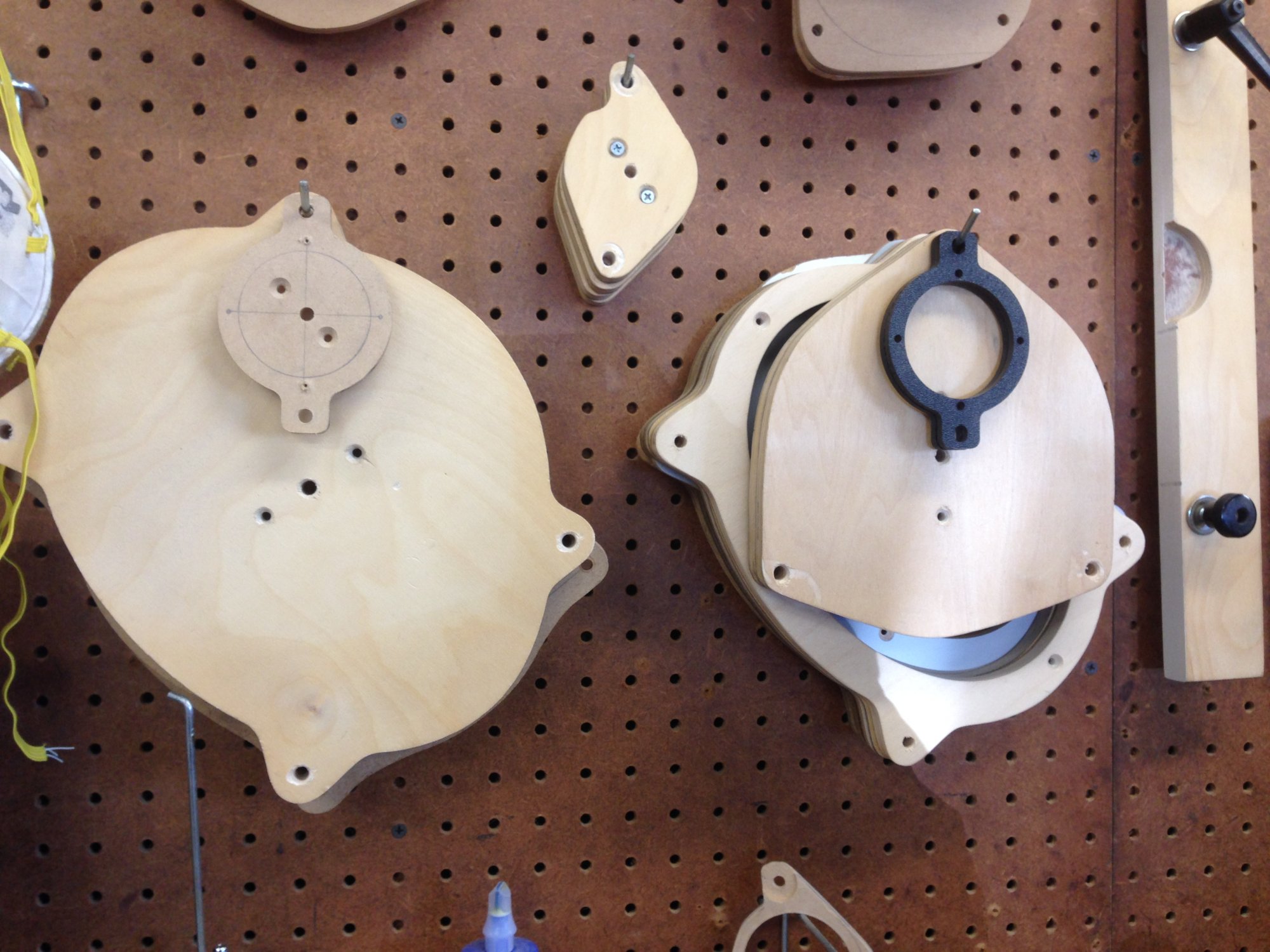

Several companies are now making 2.75" mini mids but none I have tried can reach the upper frequencies like tweeters. I used some old Polk db tweeters/crossovers I had laying around and made some adapters to fit the tweeters in the stock location however any tweeter with a flush mounting option will easily fit with an adapter (template on the left in first picture and the black set are the adapters). I cut the 6x9 door speaker  wires behind the kick panel to get signal to the crossover and from the crossover to the 6x9's in the door. I then just ran a new wire from the crossover up to the tweeter in the dash by removing the side panel from the dash.
I did it this way so I could low pass the 6x9's and have level adjustments of the tweeter to better match with the 6x9 however there are some aftermarket tweeters available that have inline crossovers and can just be connected directly to the factory mini mid wire if you don't care about low passing the 6x9's (be sure they are 4 ohm)
