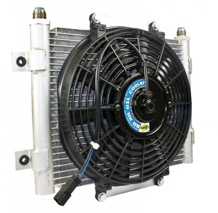

Yep, better technology. The "A.N." fittings are not cheap though. The cooler cost goes up 200-300% as well.
For a cheap plug and play option I would not recommend them, but if you want good premium performance - that is the way to go.
That's what I run on my race quads, with temp activated cooling fans and a manual activate/de-activate override switch on the bars.
They are made without A.N. fittings too. I just used your picture. The link I provided takes you to one.
We use a larger Hayden without AN fittings on every truck we've got in our yard. From '03 to '18. It's a great cooler and we've found no need for additional cooling fan

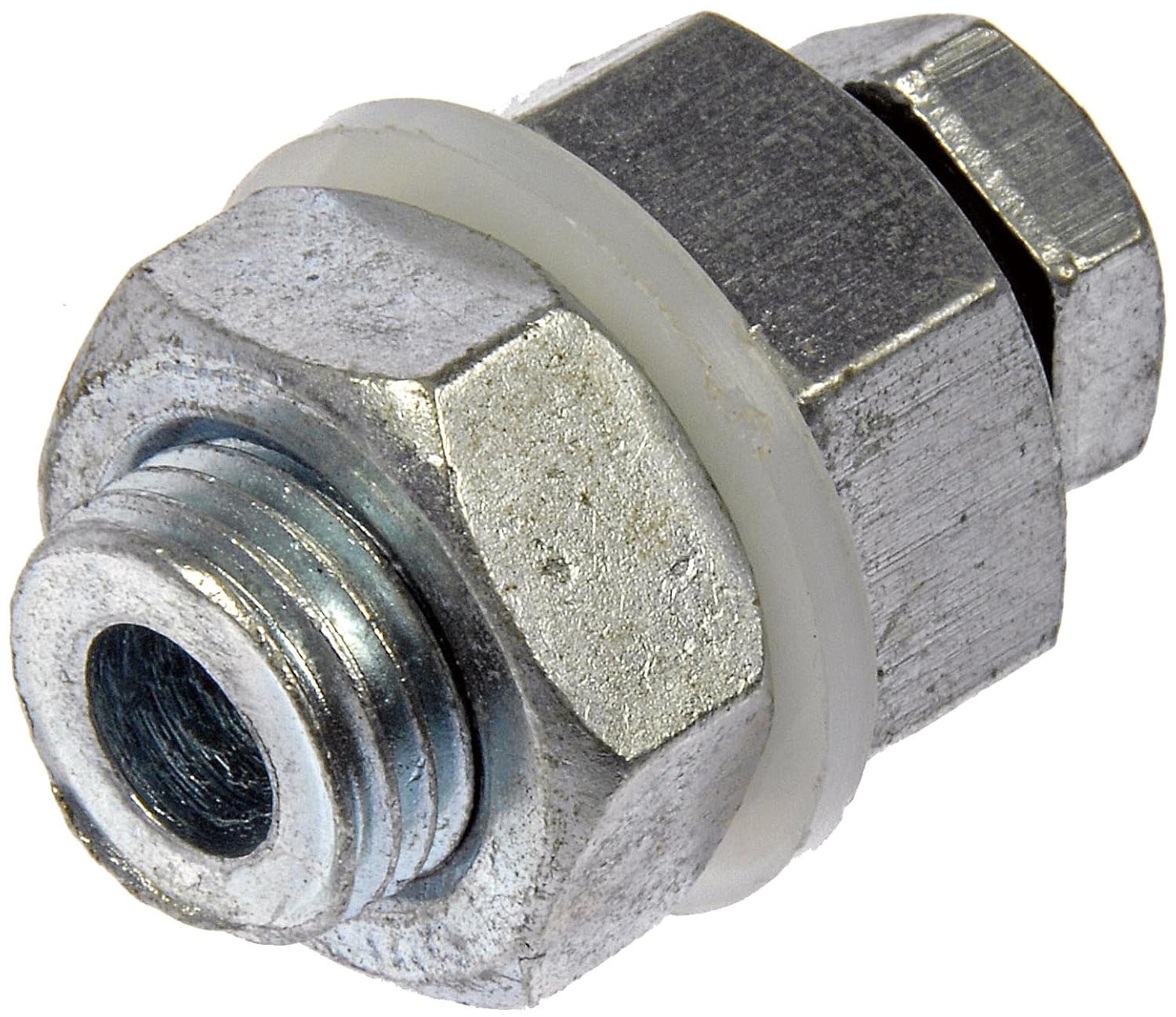

has anyone put an aftermarket drain plug on a transmission pan? I think instead of the larger pan i might just do that instead. Any aftrermarket drain plugs any one recommends? Or is that a bad idea?
I wouldnt do a drain plug on the tranny. Looking in the pan for things other than fluid is like reading tea leaves to predict its future.
2 issues i have with thru the pan fitting above. Fluid drains very slowly and wont pull any debris with it. And it leaves >1/4" fluid in the pan with all the debris in it.
