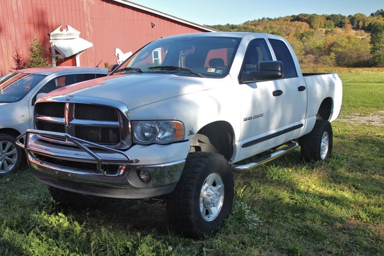

Here's a pic of my 04 Ram 2500 with 6" lift (picture is from 2013).  I put Zone 6" springs and control arms on the front, bilstein shocks, aftermarket tierods with Moog ball joints (greasable), aftermarket adjustable track bar (heim joints), dual steering dampers, Redhead steering box, steering brace, long stainless braided brake lines.  Rear got aftermarket curved leafs (no lift blocks), long stainless brake lines.  Rear axle twisted to meet drive shaft angle (shock mounts relocated for the twist).  T-case got a 3" drop and I fabricobbled my own extensions for the t-case shifter and gear selector.  All u-joints replaced with Spicers.  Diffs regeared to 4.56.  Tires are 35x12.50x17 Khumo Roadventure MT's.
