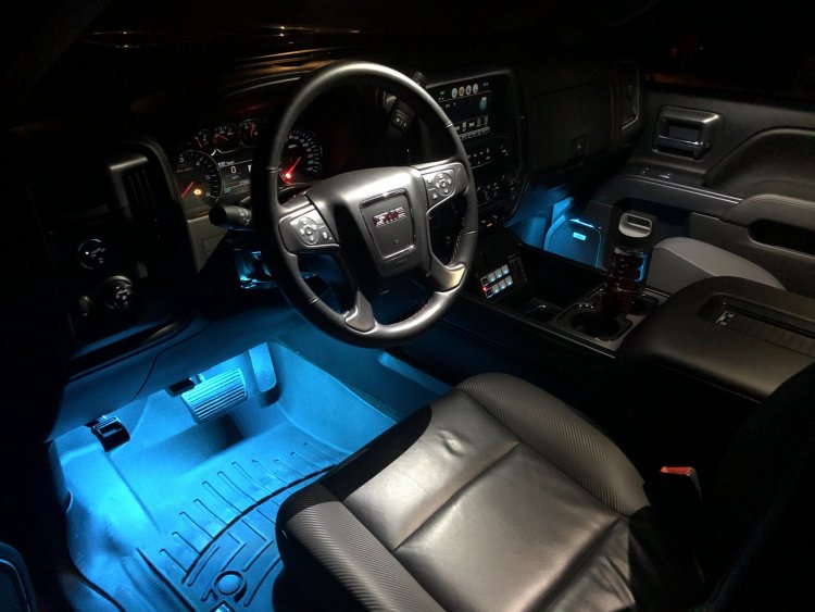

MidnightMedic90 Posted December 3, 2020 Posted December 3, 2020 On 9/18/2018 at 3:38 AM, Stockredsierra said: Never got around to contributing my install on my truck to this thread... I installed OPT7 Aura RGB+W LED strips as foot well lighting in my truck a month ago. Pictured is the fronts, but I also have them under the driver and passenger seats for the rear passengers. Pretty easy install because I have an sPOD circuit controller and HD panel. I have the lights set to blue to match the interior lighting but I have a controller to switch them to white or any other color plus a few effects like strobe and fade. They even can flash to music. I usually run them as accent lighting but if I ever drop something at night and need to see, I can flip the lights over to white. Also, the picture shows the blue lights at maximum brightness. I turn the brightness all the way down at night so they don't become distracting yet offer a nice glow. If anyone wants more pictures of how I mounted the strips or some sort of write up, let me know. The white appears more purple in the photos.. in person they are pure white. How did you address the flicker when it fades out?
