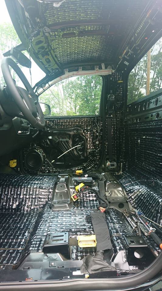

qwank Posted July 19, 2018 Posted July 19, 2018 You need more Dynomat, just around the speakers really doesn't do much. you want it at least on the outer door skins. The roof makes a huge difference too.
Willie will Posted July 19, 2018 Posted July 19, 2018 I agree with qwank. I have a Chevy S10 and installed dash and door speakers. I installed some dynamat on my door and on the inside of my door. Made a huge difference! No rattle and eliminates road noise. I did both doors and that’s it. I’ll eventually door the floor and roof to get rid of all road noise. I would definitely put some dynamat right behind the speakers in the door.
