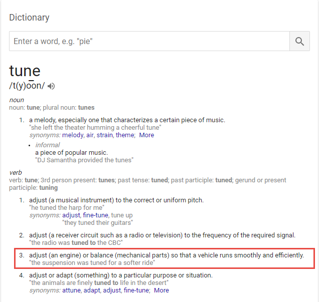

On 8/1/2018 at 9:06 PM, TJay74 said:
Huh??? The dealer most certainly "tune" modules in the sense that when GM had them flash a firmware into the OP's TCM at that point the dealer was tuning the TCM. GM does revise calibrations based on issues and then has those calibrations flashed when work is done.
That would be a very broad interpitation of the general meaning of "tune".
