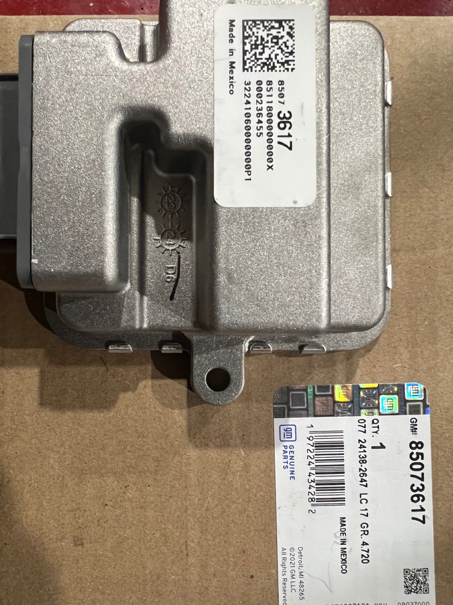

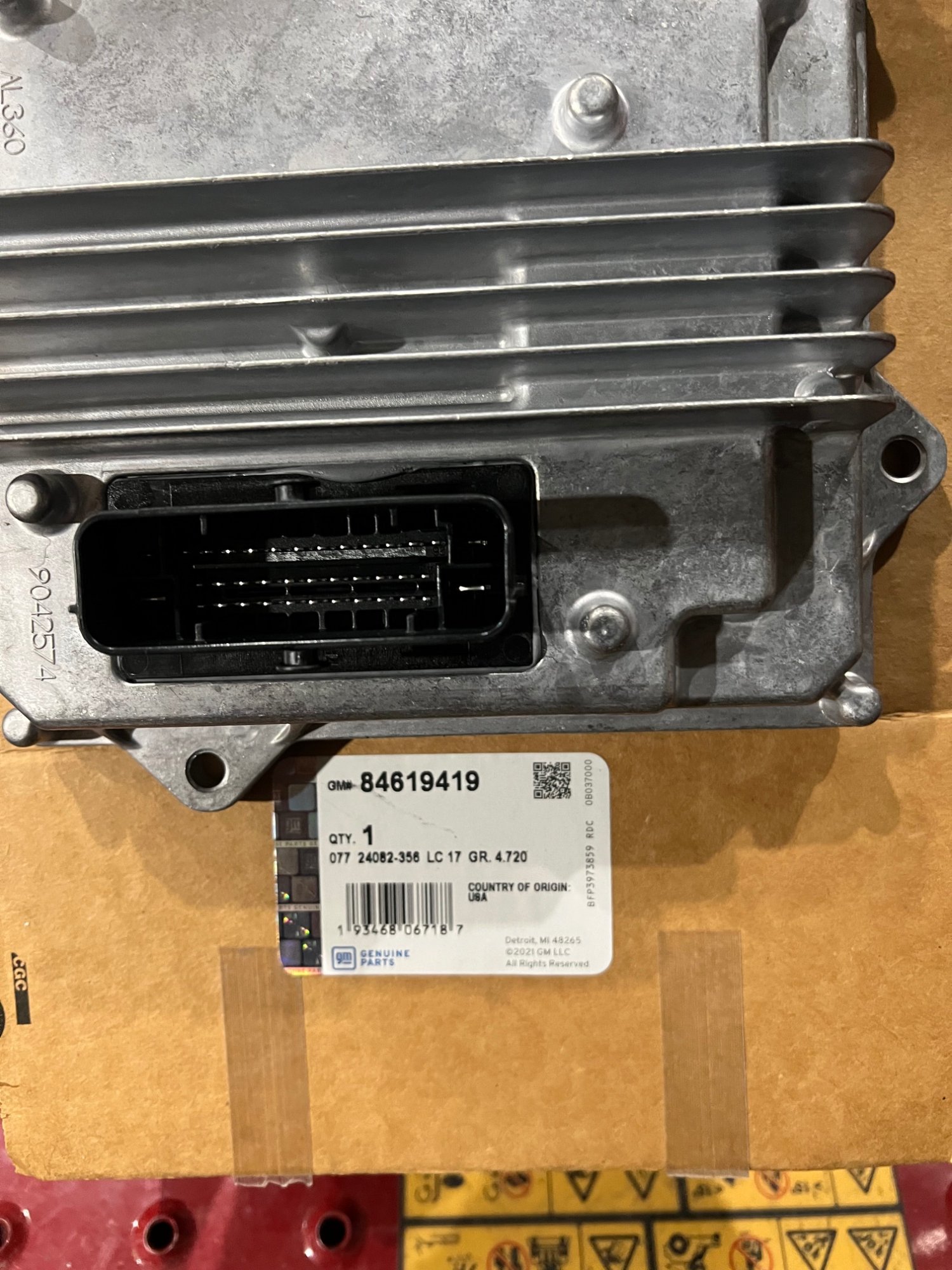

Once I get home from work, I’ll get OEM part numbers for the modules. Keep in mind that this is not a simple buy a harness and plug and tow. Could you acquire a harness from a salvage yard, yes you could but then you a lot more to sort out cause as with JL1, if you have park assist sensors, the the rear camera, the magnaride suspension and so on, you’d have to get a harness from a truck that has all the same RPO’s as your truck with JL1 cause those wires would for those options would be present in the harness.
