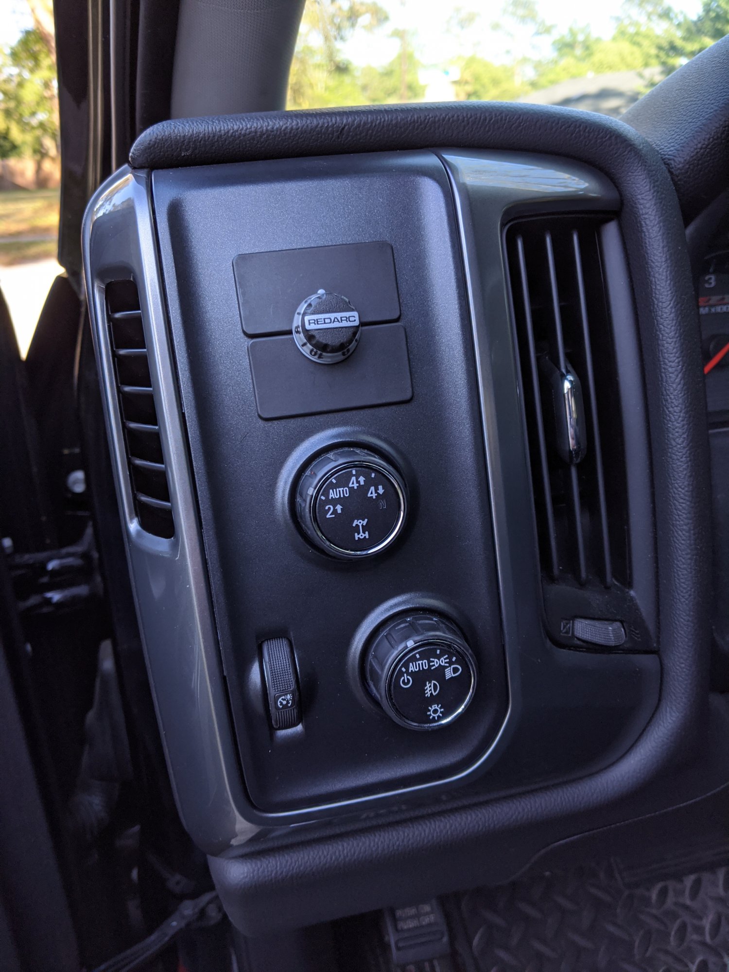

Stock controller can't be added later which is lame ...I went with the Redarc controller too, for the remote control ...here's my version
Edited by Pinky Z71
