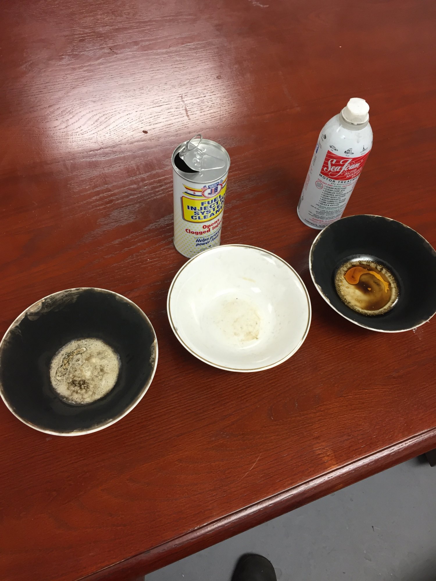

I agree. 20 years ago when they were promoting the brand and using quality products, it was a good product because they were losing money with it. Then it became a household name because of how good it was and then they changed the formula to be more cost effective. Great marketing strategy. Do this though, Take a white dollar store bowl and put a little bit of seafoam in the bowl and set it on fire. See what you're left with and decide if that's what you want to be left with in your engine when it burns. It's cool that you have been using it for 20 years and all... But times change and so do cars and products. I WOULD LOVE TO DISCUSS OIL! :D
Went ahead and did the test again at work today to show what I am talking about. The first bowl is just 1/8 cup of plain 87 fuel. The second bowl is 1/8 cup of 87 fuel mixed with 1tbs of JB injector cleaner and 1tbs of water. The third bowl is 1/8 cup of 87 fuel, 1tbs seafoam, 1tbs water. (I added the water to show which would also remove water from the system. Here are the results. I wish you could touch the slime/goop in the bottom of the seafoam. It is like pure honey.
That is crazy! Personally I have used seafoam and loved it.. brought back quite a few small engines with it without tearing the carbs apart from ethanol garbage.
BUT, that JB injector cleaner sure did work lol.
