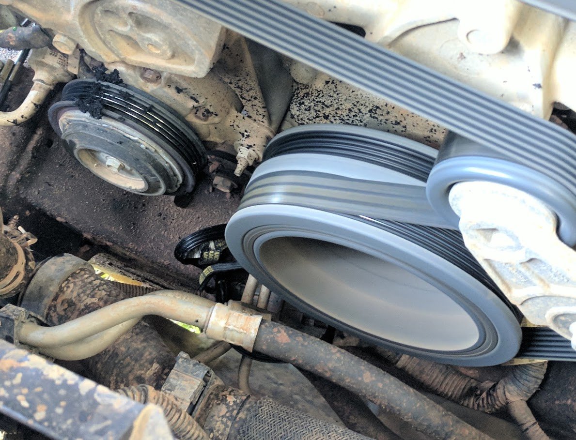

My condenser went out around 36k.  I called the dealer, I called GM, I filed a case against GM, filed a complaint in BBB, and filed a case with the Michigan attorney general.  All of which GM denied.  So, now they are having to deal with me and others in court.  I attached a few pics.  Burnt out the belt too when it froze up.  You can see all the rubber flung (southern vocab?) everywhere.  The failure cracked the compressor housing.

It's unfortunate but it's the only issue I've had with my truck. I was hoping GM would stand behind their trucks better. I know more people have had condenser issues rather than compressors so it could very well be the condenser.
