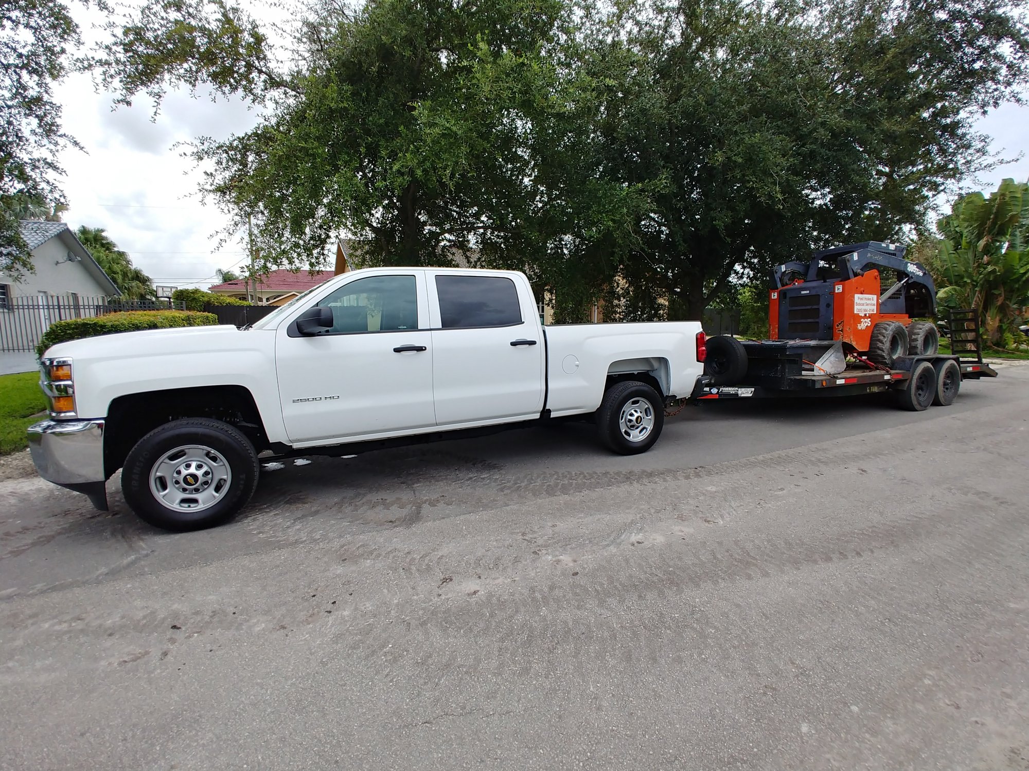

Just got a 2018 2500hd. Pulling my trailer with bobcat, bucket and auger. 9500-1000 lbs with trailer. Smooth sailing
