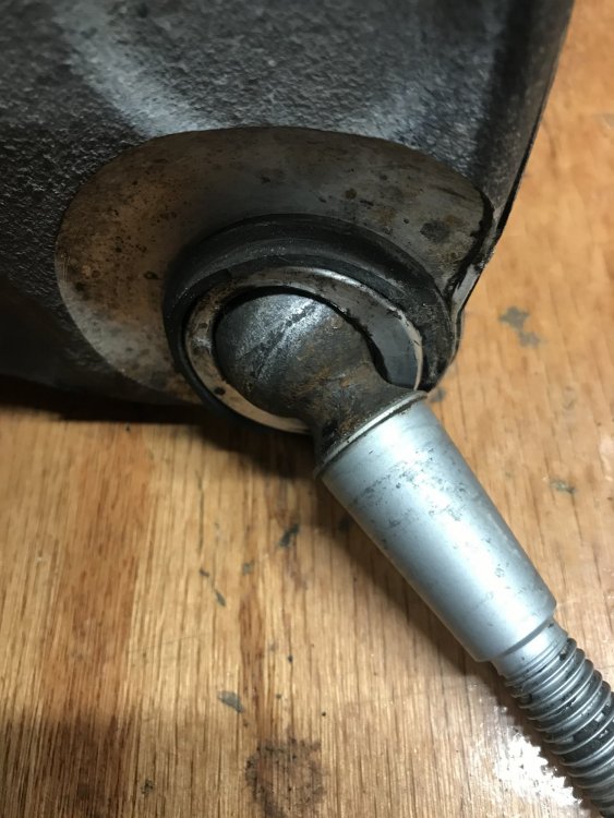

ALLSTAR Posted October 26, 2020 Posted October 26, 2020 1 hour ago, Mike may said: The control arms where stock, just ordered ready lift leveling kit with upper control arms designed to change the geometry of the stress on the components especially the control arm and ball joints The only modification i did on my truck was the 1" spacer. Scared the hell out of me when that tire folded and locked up !. So that's 2 trailboss trucks that failed. It appears factory 2" plus 1" for 3" total is to much upper ball joint angle. Beware trailboss owners with lift blocks without upgraded upper a-arms ! .

ALLSTAR Posted October 27, 2020 Posted October 27, 2020 31 minutes ago, ALLSTAR said: I installed them myself. Its just a spacer, 2 bolts, Its pretty easy to install, you really cant do it wrong. I could post a pic when it gets light out. Went right to alignment shop and they had to do a minor adjustment. Here is closer view of ball joint

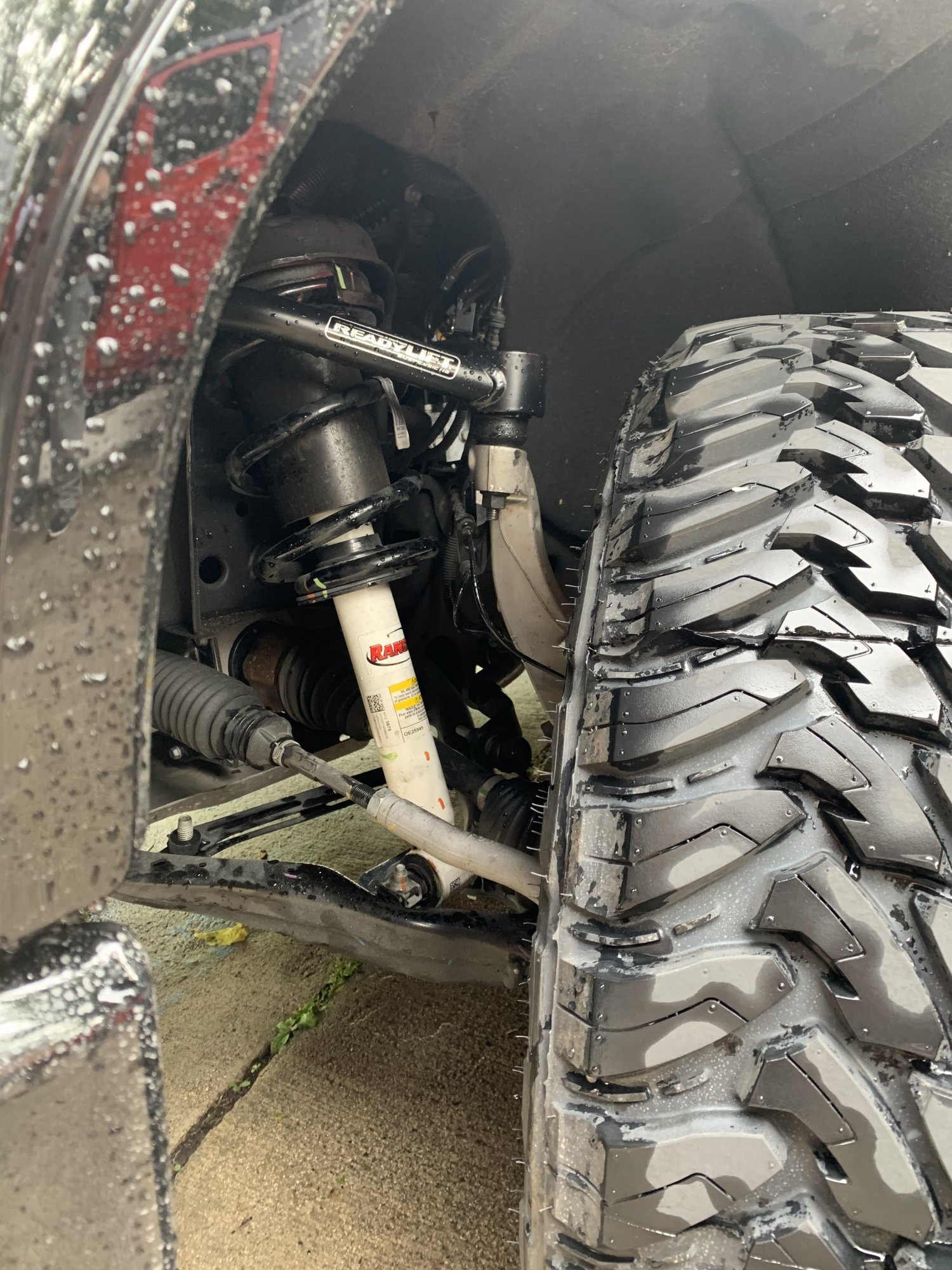

BEnax Posted October 28, 2020 Posted October 28, 2020 On 10/26/2020 at 12:59 PM, Mike may said: The control arms where stock, just ordered ready lift leveling kit with upper control arms designed to change the geometry of the stress on the components especially the control arm and ball joints Hello I have a 2020 at4 with the 1.75” leveling kit with control arms. On these trucks they recommend control arms with a leveling kit. To keep all the angles right for the cv axel joints etc. I’ve had it in for about 2 months now. Zero problems at all, truck might even ride better. I also have the truck sitting on 22x12 -51 offset with Toyo 33x12.5
